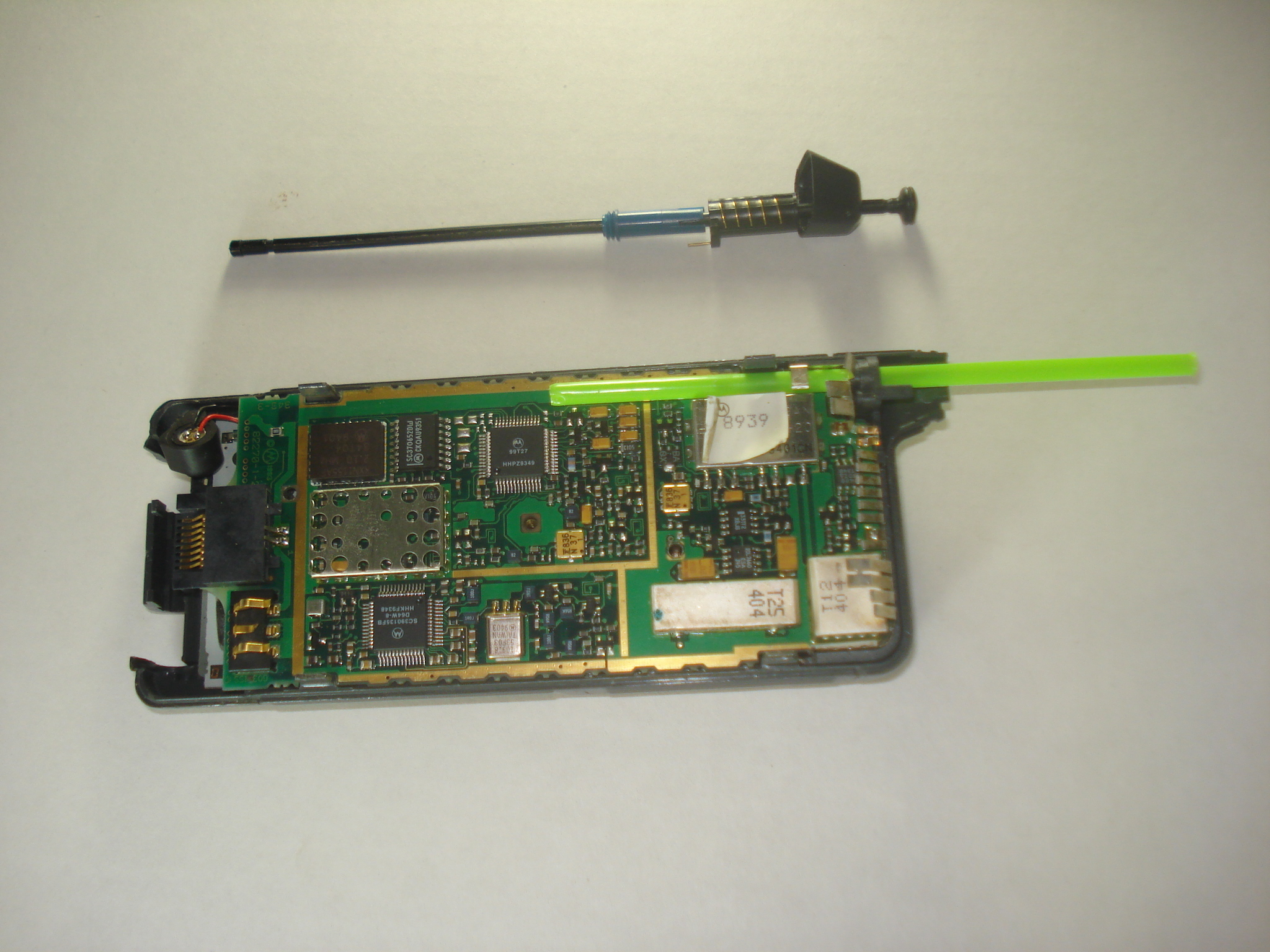

  • Slide off the antenna guard and locate the four clips on the exterior of the ear casing.
  • Simultaneously push the clips outward while lifting the rear casing and keyguard away from the front casing.
Image #1

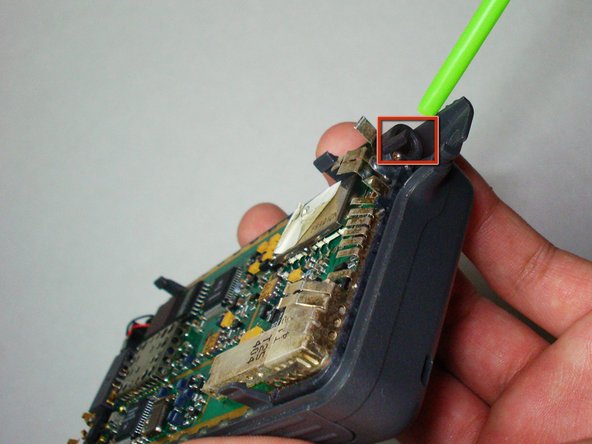

Add Note Edit Step 4  ¶
  • Locate and unplug the black component of the old antenna from the motherboard.
  • Under the black component should be a blue component. Unscrew this component in order to free the antenna.
Image #1
Add Note Edit Step 5  ¶
  • Slide the antenna out of the green tubing.
  • If replacement is needed, also slide the old green tubing out of it's corresponding hole on the motherboard.

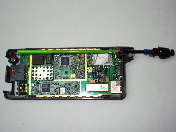

Add Note Edit Step 6  ¶
  • Insert the new green tubing into the slot provided on the motherboard.
Image #1
Add Note Edit Step 7  ¶
  • Insert the antenna into the green tubing.
Image #1
Add Note Edit Step 8  ¶
  • Screw the blue piece of antenna into the threaded hole on the motherboard until it is snug.
