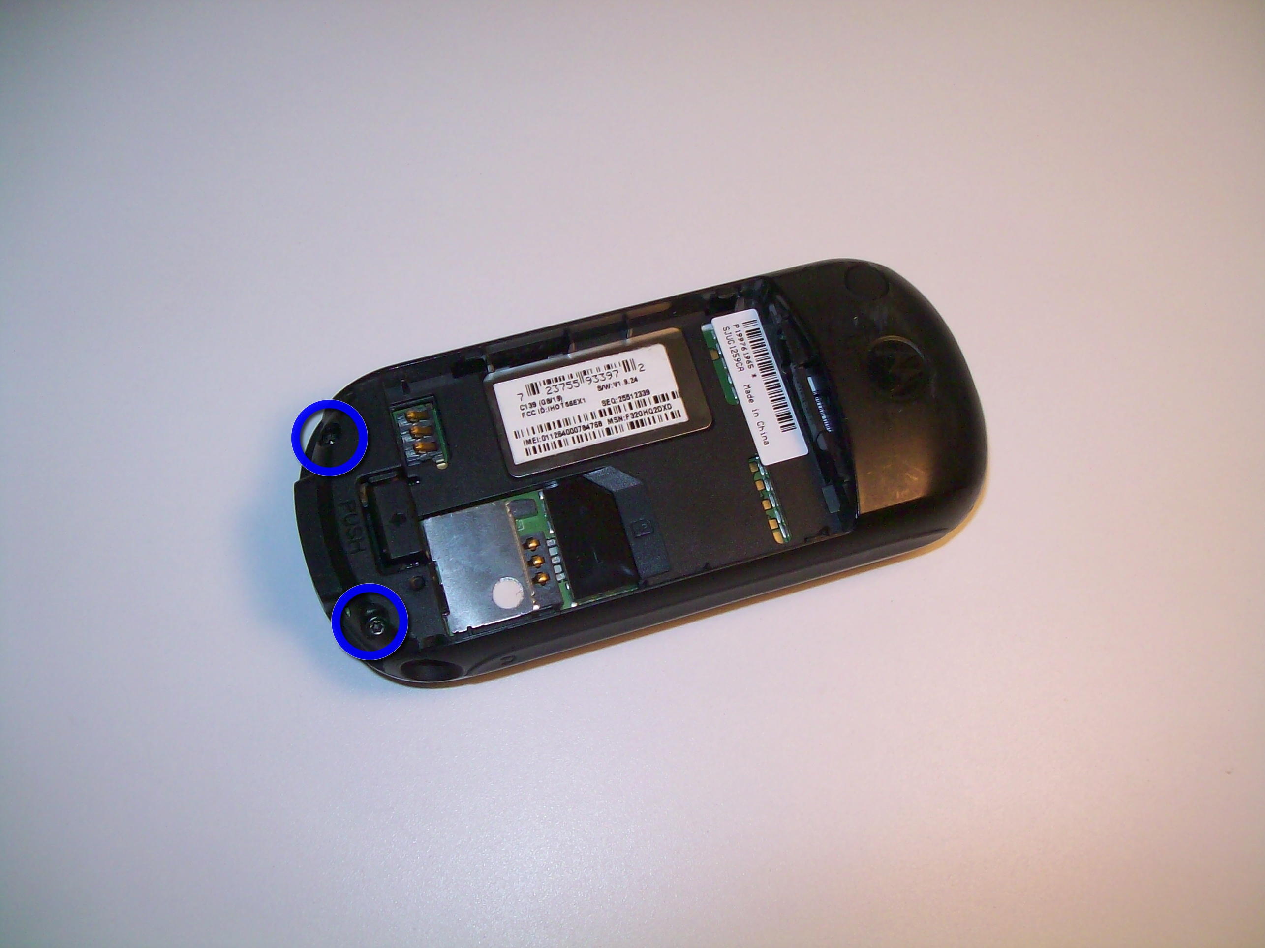

  • Use a Torx T-5 screwdriver to remove the screws on the back of the phone.
  • The screws are 6.86 mm long and 1.61mm in diameter.

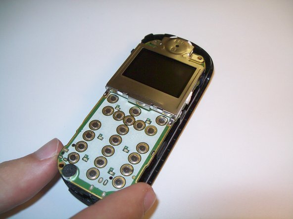

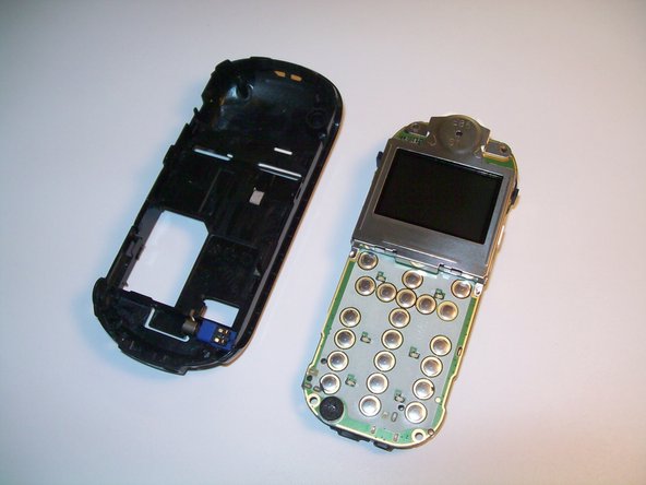

  • Use plastic pry tools to free the circuit board from the case
    • There are two hooks (one on each side) holding the circuit board into the case.
  • Then grip the circuit board and lift to remove the circuit board from the case
