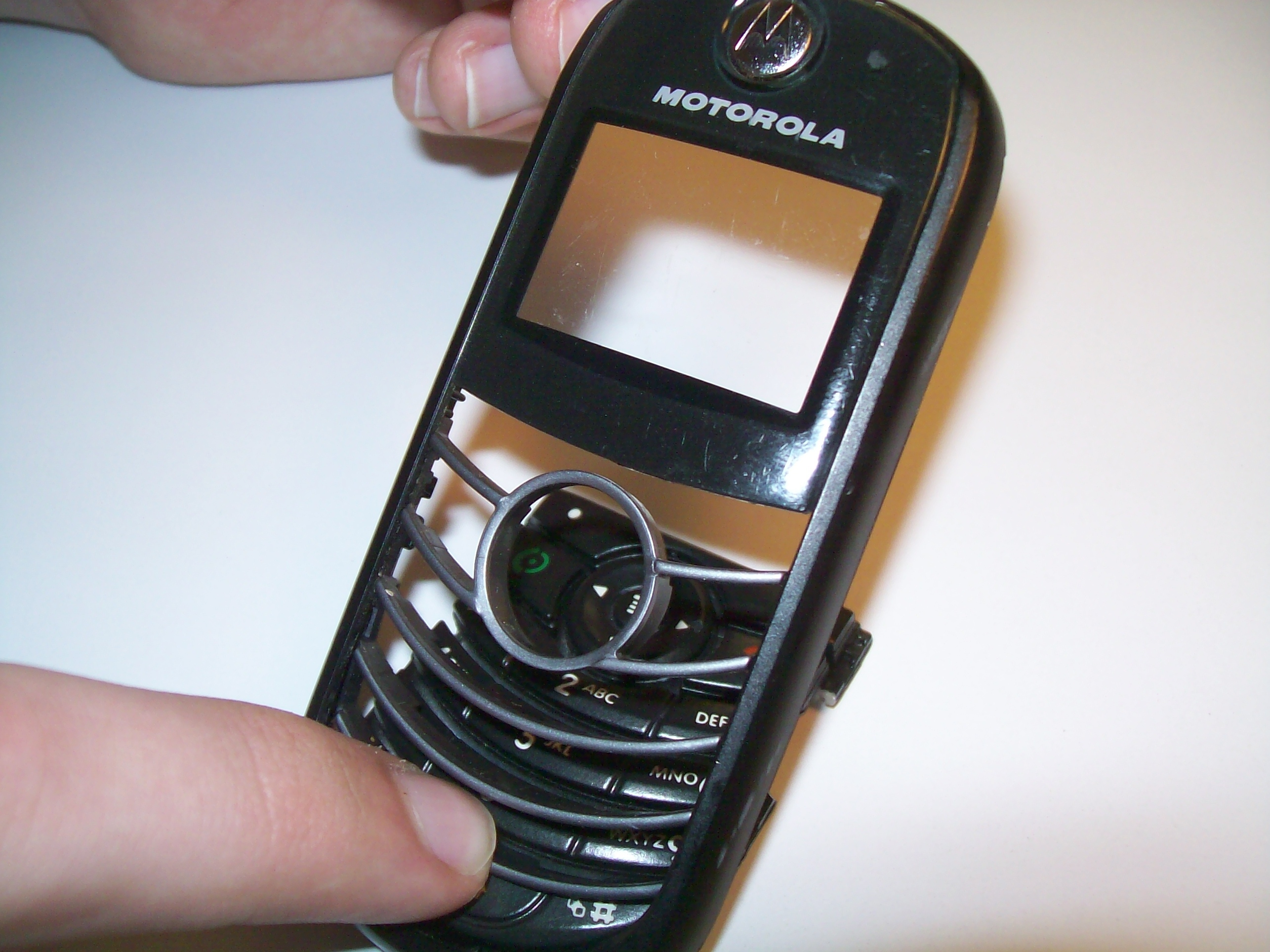

Add Note Edit Step 8 — Keypad & Faceplate  ¶
  • On the top half of the phone push downwards on the number keys to free the keypad from the top of the phone.
