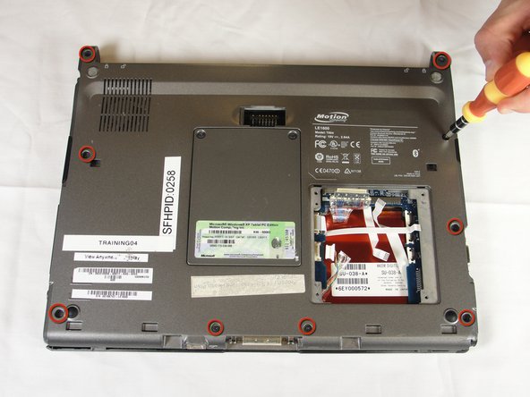

Add Note Edit Step 9  ¶
  • With a Phillips #1 screwdriver, Unscrew the nine 10mm screws holding the case together.
Image #1 Image #2

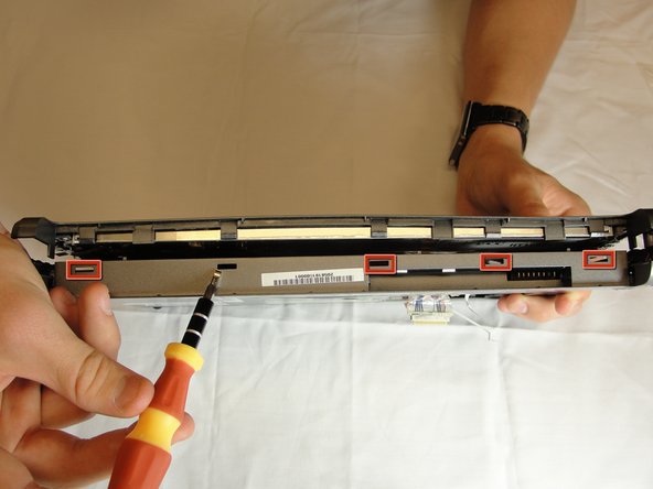

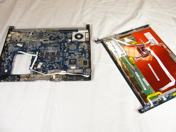

Add Note Edit Step 10  ¶
  • Using a spudger, press in the five tabs on the side where the battery was.
  • This should separate the two halves of the device. Carefully set the side with the motherboard off to the side.
Image #1 Image #2

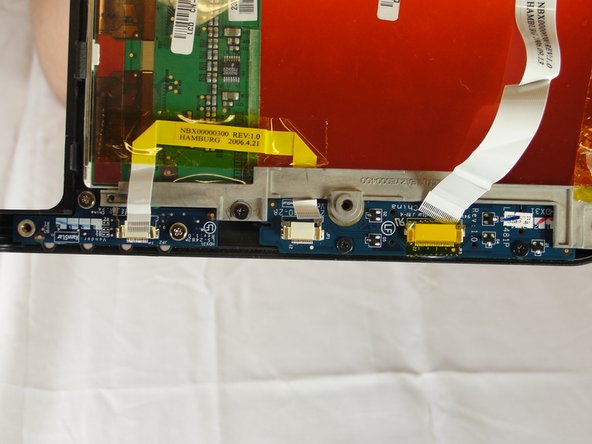

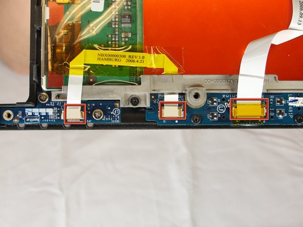

Add Note Edit Step 11  ¶
  • Unplug the three ribbon cables by pulling on the brown tabs and unplugging cable.
Image #1 Image #2

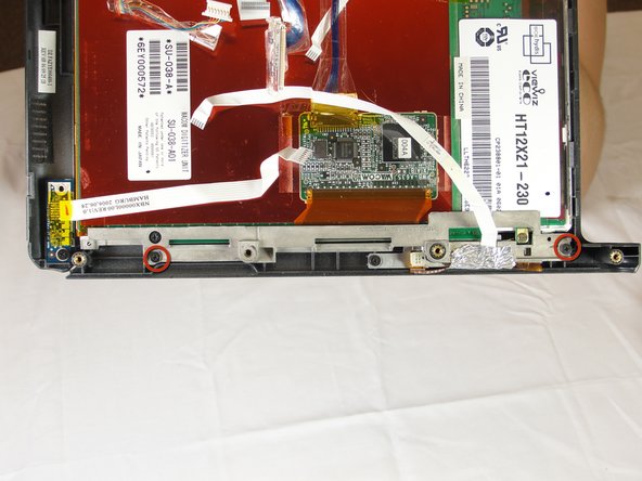

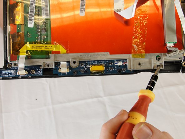

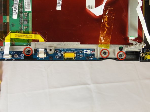

Add Note Edit Step 12  ¶
  • With a Phillips #1 screwdriver, unscrew the three 4mm screws holding the display bracket on the back side of the front buttons.
Image #1 Image #2 Image #3

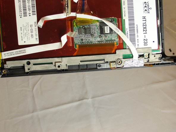

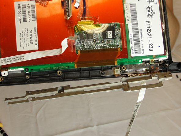

Add Note Edit Step 13  ¶
  • On the bracket behind the fingerprint scanner, unscrew the two 4mm screws holding it to the display with a Phillips #1 screwdriver.
  • Fold away right bracket from display.
Image #1 Image #2

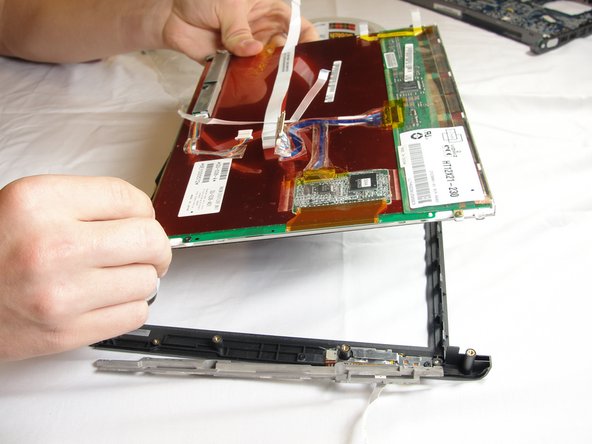

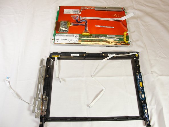

Add Note Edit Step 14  ¶
  • Pull the plastic case away from the display screen.
