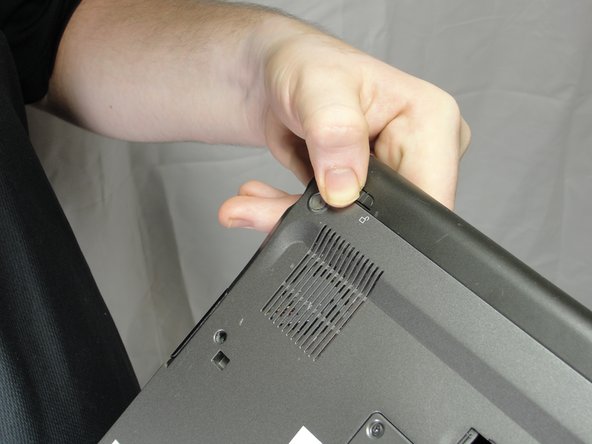

  • Slide and hold the switch by the fan vent to the unlocked position. Firmly grasp the battery and pull away from tablet.
  • When replacing the battery, place the end near the fan vent in first. Make sure to keep the other switch in the unlocked position while pushing the battery into place.

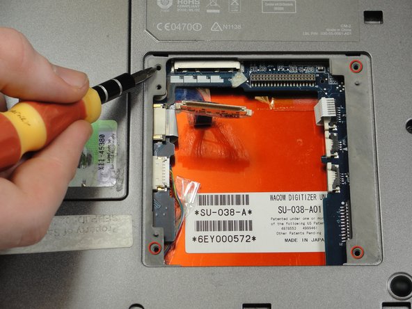

  • Unscrew hard drive panel using a Phillips head #1 screwdriver.
  • (Our device was not given to us with a hard drive or a hard drive panel)

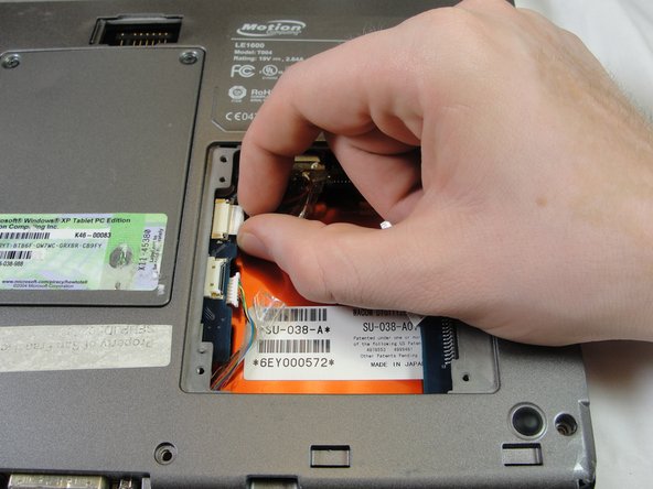

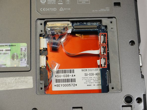

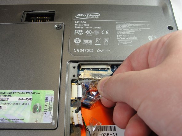

  • Pull clear plastic tab to detach hard drive from tablet.
Image #1 Image #2
Add Note Edit Step 6  ¶

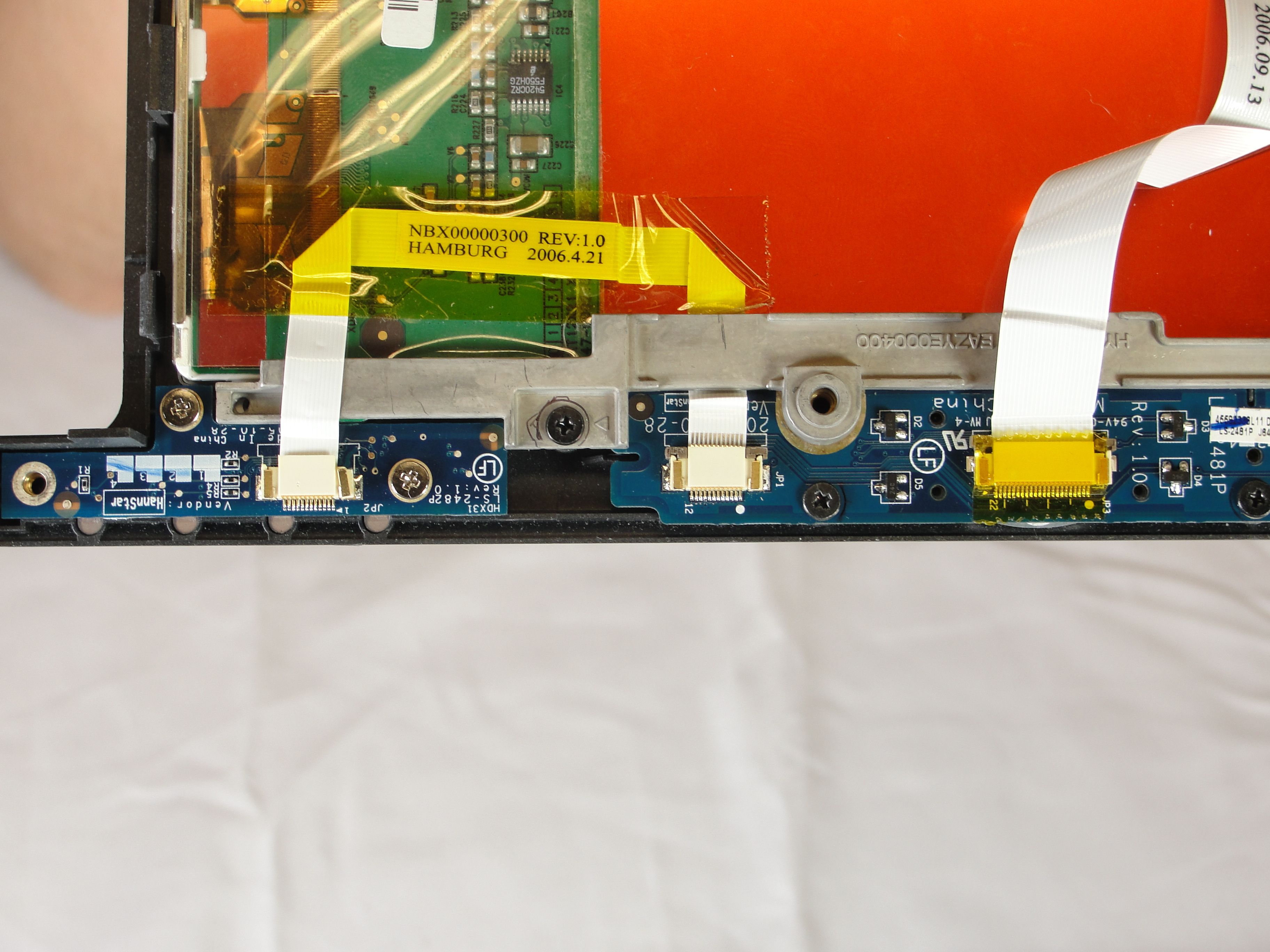

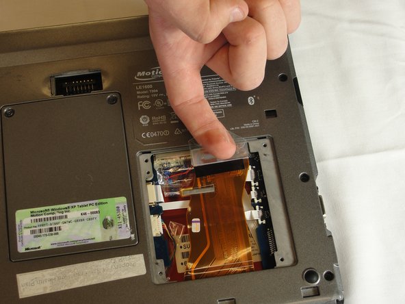

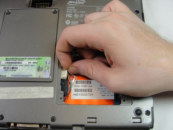

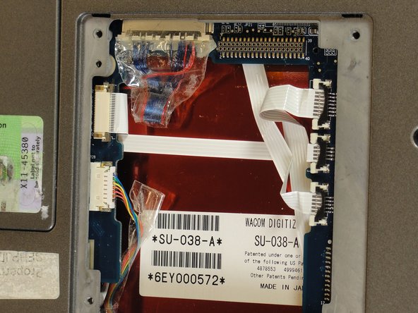

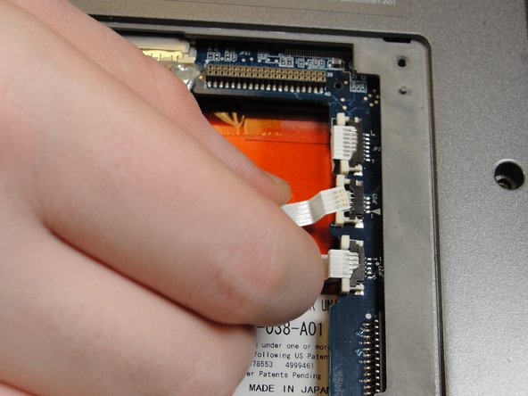

  • To disconnect the three white ribbon cables on the side closest to the hard drive connector, pull the white plastic tabs.
Image #1
Add Note Edit Step 7  ¶
  • Pull the brown tabs to disconnect the white ribbon cable on the other side.
Image #1 Image #2
Add Note Edit Step 8  ¶
  • Caution: do not pull on the wires, instead pull from the plastic connectors.
  • To disconnect the remaining ribbon cables, pull the plastic connectors away from their connections.
