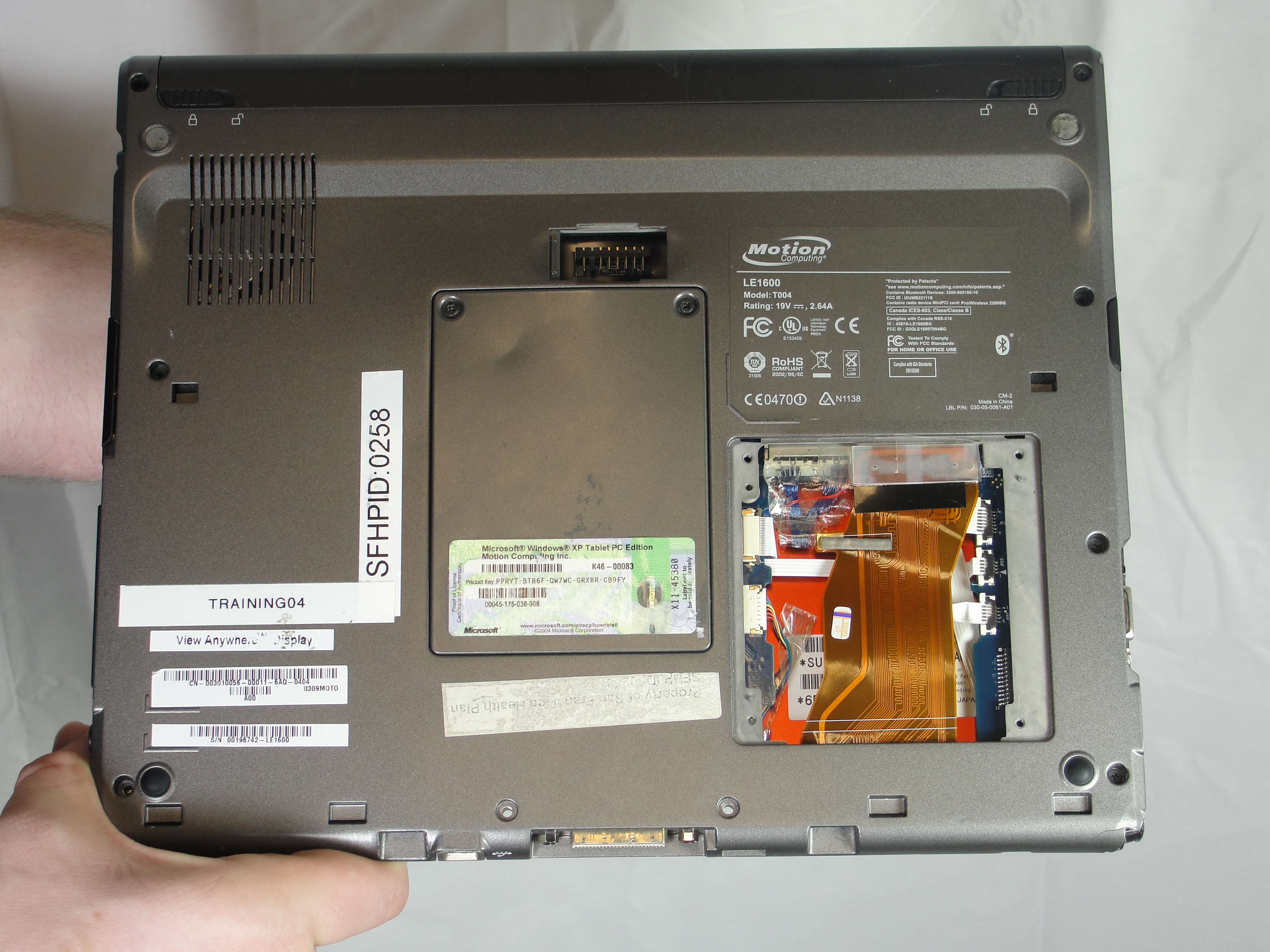

Before you start anything, you should always remove the battery. This guide will take you through this process.
Image #1
  • Turn the device so the screen is facing down.
Image #1 Image #2
Add Note Edit Step 2  ¶
  • Slide the battery lock switch next to the power slider to the unlocked position.
Image #1 Image #2 Image #3
Add Note Edit Step 3  ¶
  • Slide and hold the switch by the fan vent to the unlocked position. Firmly grasp the battery and pull away from tablet.
  • When replacing the battery, place the end near the fan vent in first. Make sure to keep the other switch in the unlocked position while pushing the battery into place.
