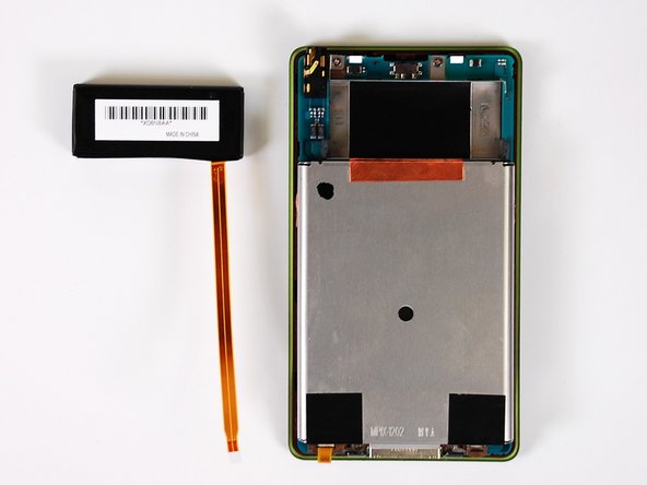

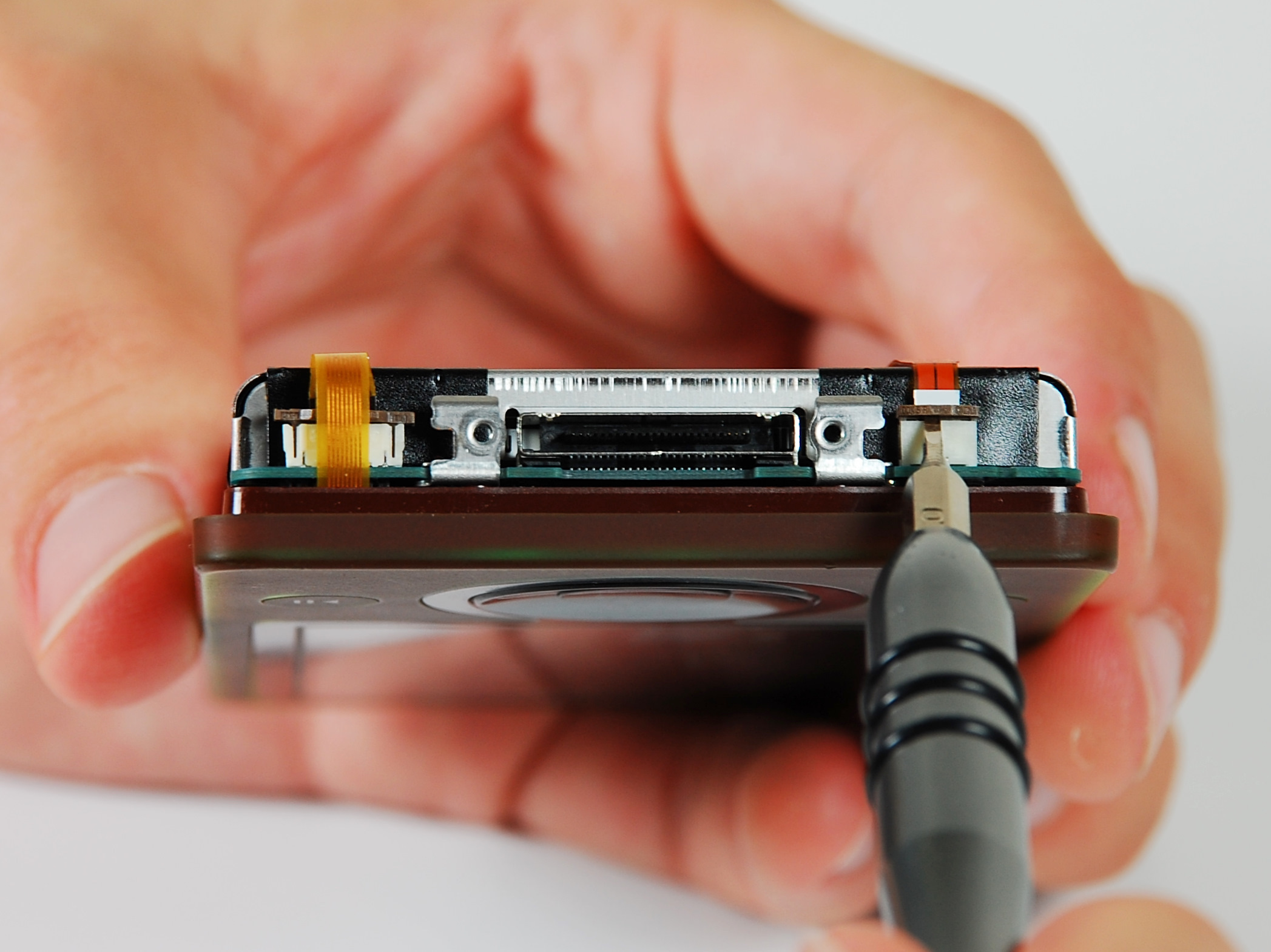

Remove the ribbon cable that attaches the battery to the logic board. If the brown latch is lifted too high it will detach and the white piece might fall off during later steps.

Add Note Edit Step 5 — Battery  ¶
  • With the Zune facing down as pictured, the battery ribbon cable is attached to the bottom right hand side of the logic board.
  • Use the small flat head screw driver to lift the brown clamp.
  • The brown clamp will release the battery ribbon cable from the logic board, freeing the battery.
Image #1
Add Note Edit Step 6  ¶
  • You can now replace your battery!
  • The battery is a Lithium ion 3.7 V.
