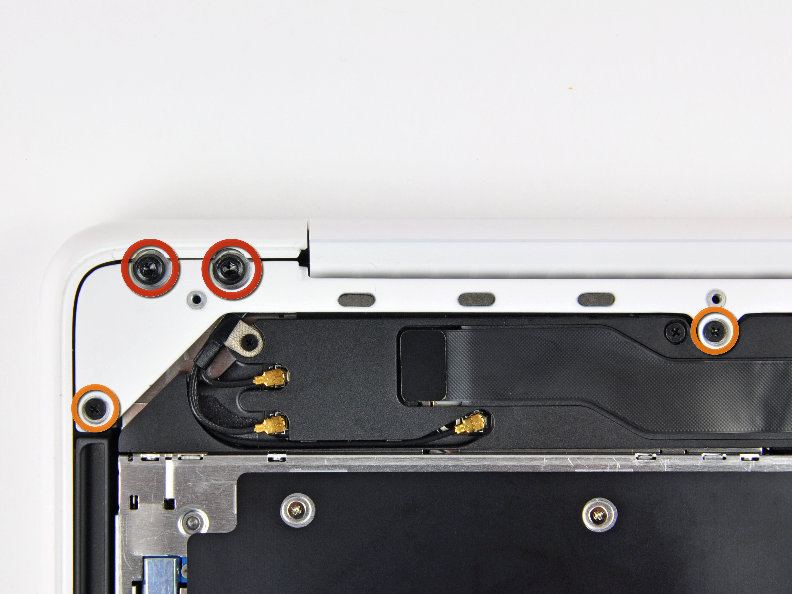

  • Remove the following screws from the optical drive side of the rear vent:
    • Two 10 mm T8 Torx
    • Two 5.2 mm Phillips
Image #1
Add Note Edit Step 5  ¶
  • Remove the following screws from the port side of rear vent:
    • Two 10 mm T8 Torx
Image #1
Add Note Edit Step 6  ¶
  • Carefully lift the rear vent out of the upper case.
