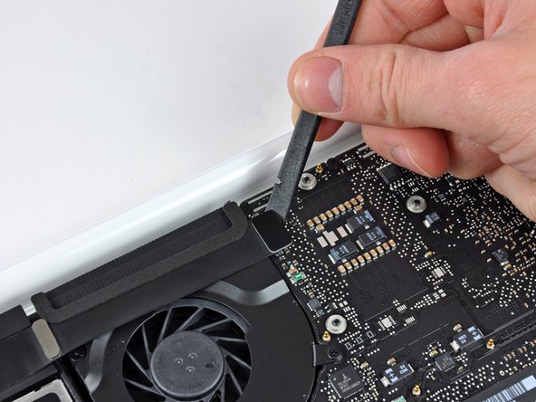

Add Note Edit Step 7 — Rear Speaker Assembly  ¶
  • Use the flat end of a spudger to pry the AirPort/Bluetooth cable connector up off the logic board.
Image #1

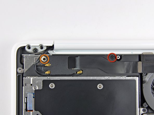

Add Note Edit Step 8  ¶
  • Remove the following screws securing the right speaker assembly to the upper case:
    • One 12 mm Phillips screw.
    • One 3 mm Phillips screw.
