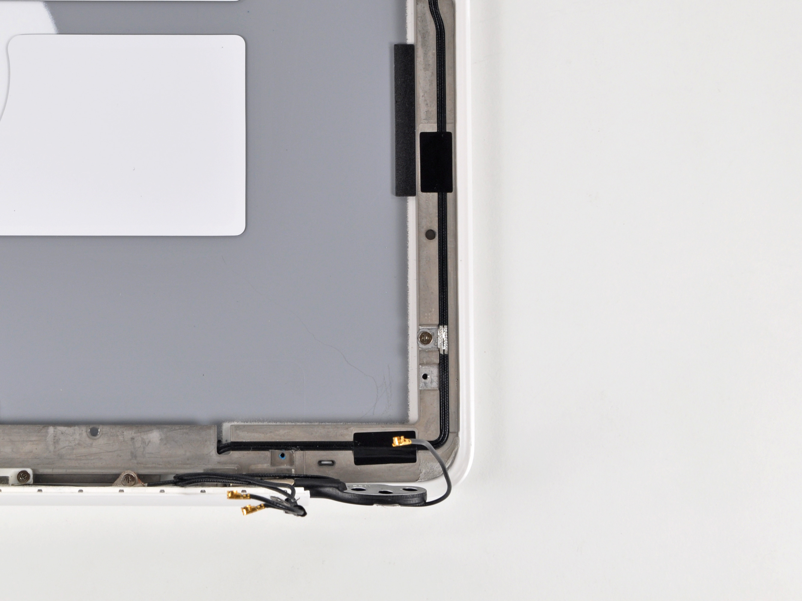

Add Note Edit Step 7 — Display  ¶
  • Remove the single 3 mm Phillips screw securing the AirPort/Bluetooth antenna ground strap to the rear speaker.
Image #1 Image #2
Add Note Edit Step 8  ¶
  • Use the tip of a spudger to pry the AirPort and Bluetooth antenna connectors (3 total) up off the AirPort/Bluetooth card.
  • De-route the long antenna from its channel in the rear speaker housing.
