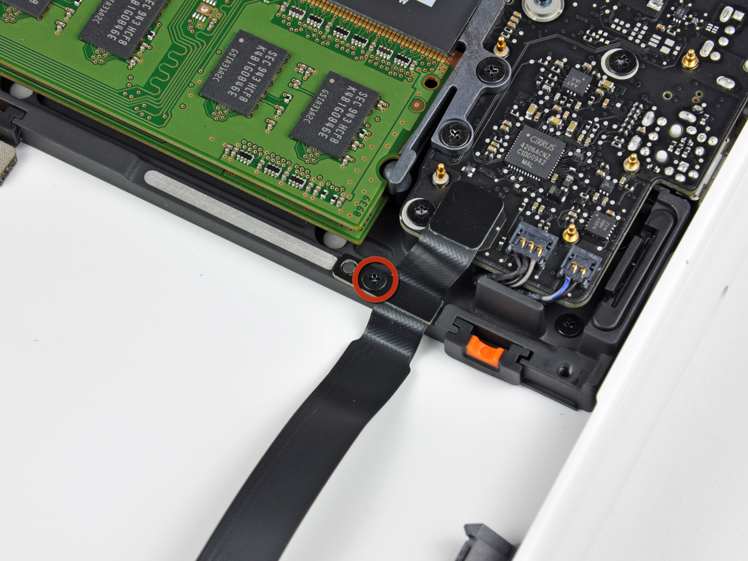

Step 6
Lift the hard drive by its pull tab and pull it away from the upper case, minding the cable still attaching it to the logic board.
In some revisions of the MacBook A1342, the hard drive bracket may include two rubber brackets (as highlighted in the second picture.) The correct orientation of the rubber brackets is shown in the third picture.
