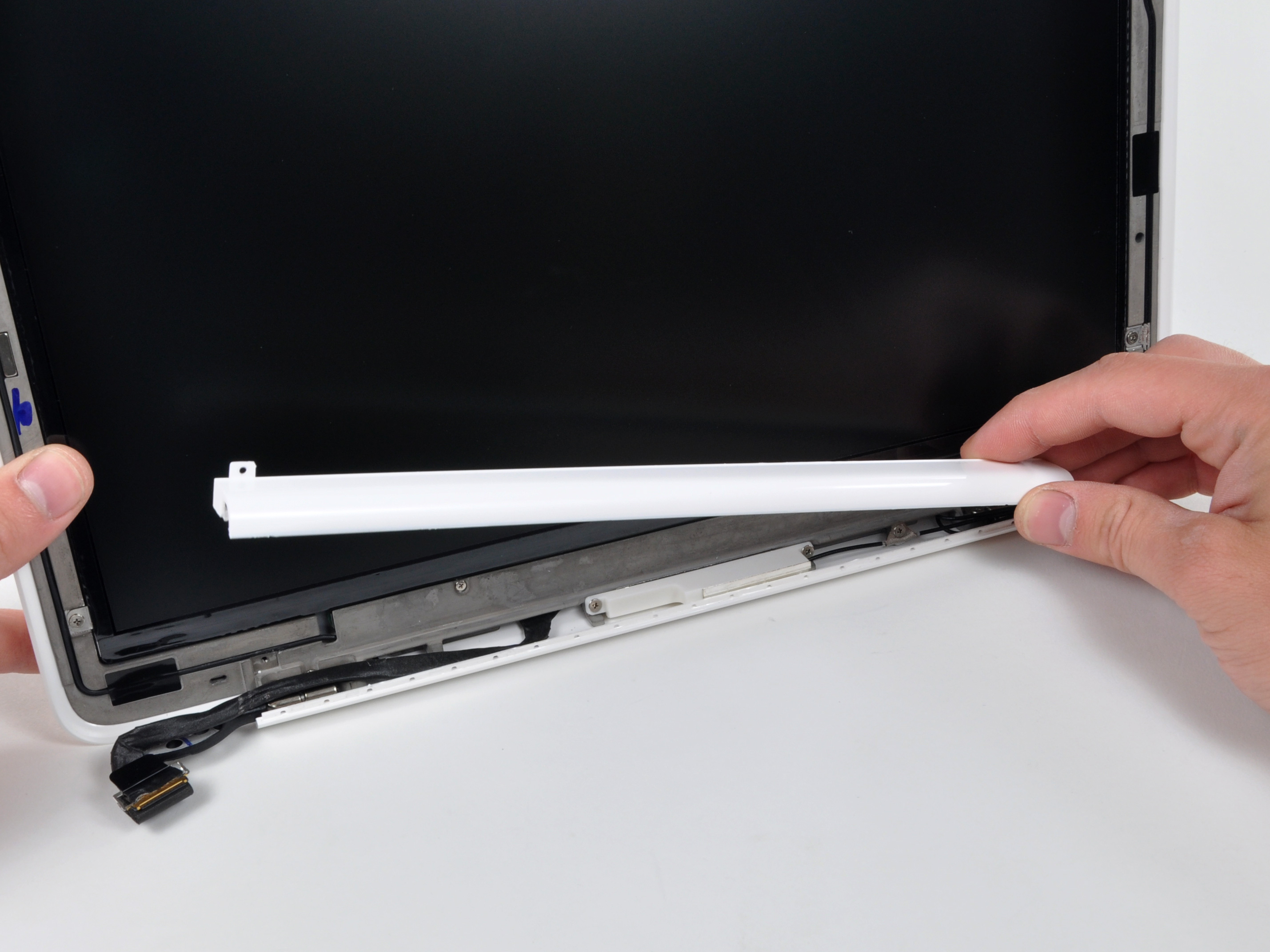

Installing MacBook Unibody Model A1342 Clutch Cover
Replace a damaged clutch cover.
  • Add Note x
  • x 3
Remove the clutch cover to access cables terminating inside the display.
