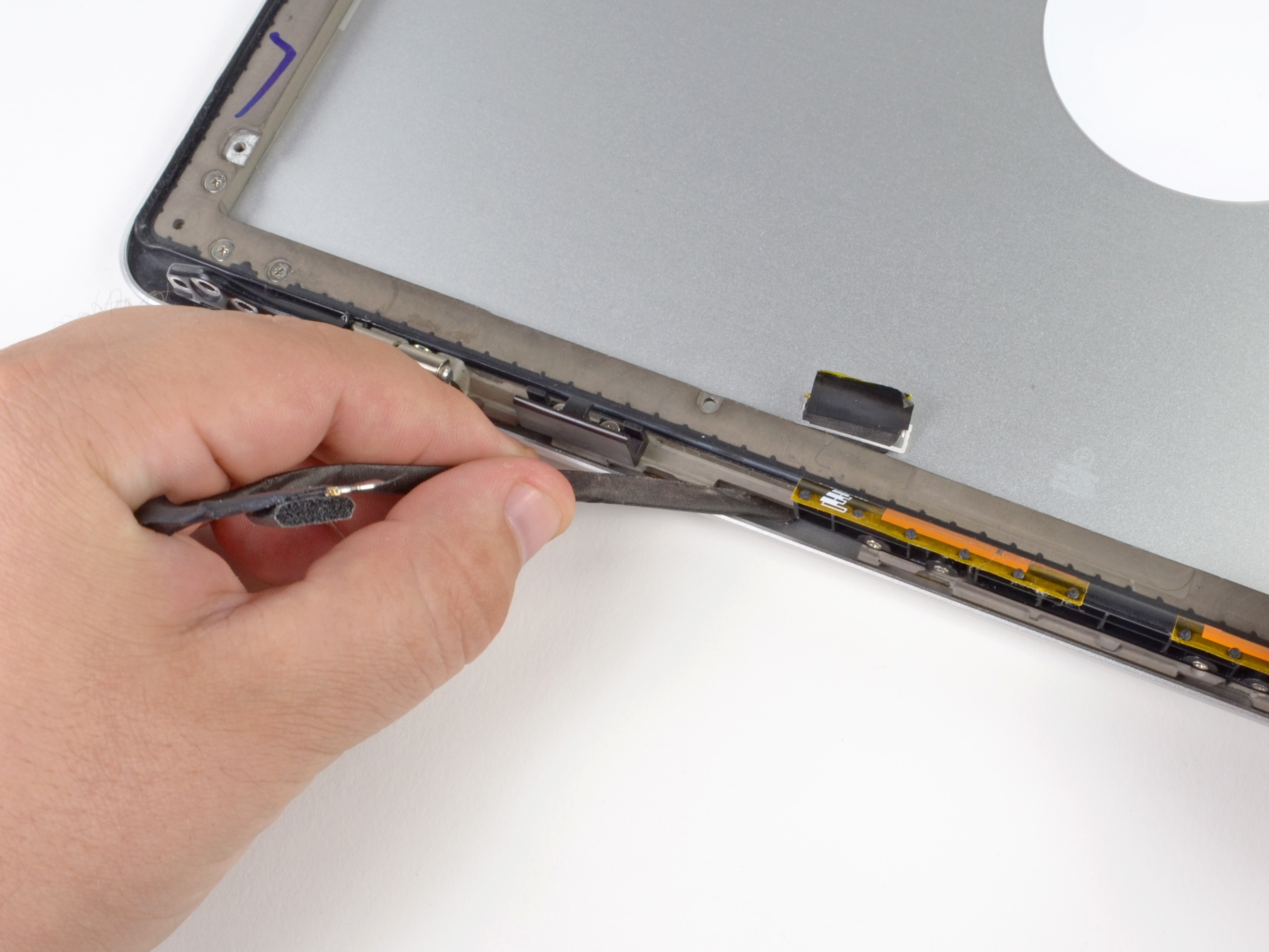

  25. MacBook Unibody Model A1278 LVDS Display Cable Replacement, Clutch Cover: step 25, image 1 of 2 MacBook Unibody Model A1278 LVDS Display Cable Replacement, Clutch Cover: step 25, image 2 of 2
    • Slide the clutch cover toward the right edge of the display.
    • The clutch cover will move approximately .5" and stop. Do not force it too far to the right.
    • When reinstalling the clutch cover, be sure to slip it over the components protruding from the lower edge of the display about .25" to the right of its final installed position on the display.
  26. MacBook Unibody Model A1278 LVDS Display Cable Replacement: step 26, image 1 of 3 MacBook Unibody Model A1278 LVDS Display Cable Replacement: step 26, image 2 of 3 MacBook Unibody Model A1278 LVDS Display Cable Replacement: step 26, image 3 of 3
    • Starting at its far right end, rock the clutch cover along its long axis while pulling it away from the clutch hinge.
    • Working from right to left, carefully continue to release and lift the clutch along the lower edge of the display assembly.
    • Lift the clutch cover up off the front bezel and set it aside.
    • When reinstalling the clutch cover, be sure to widen the opening when slipping it over the small black plastic cosmetic cover that fills the open end of the clutch cover when it is in place. The cosmetic cover has very thin and delicate plastic arms that hold it to the right clutch hinge.

    • Carefully route the LVDS display data cable through the slot located to the left of the antenna assembly.
    • Do not use excessive force as you may damage the LVDS display data cable.
    • Lift and remove the LVDS display data cable from the display assembly.
