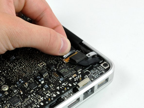

  • Disconnect the display data cable by pulling the male end straight away from its socket.
Image #1

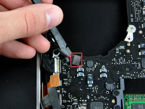

Add Note Edit Step 21  ¶
  • Use the flat end of a spudger to pry the subwoofer cable connector straight up off the logic board.

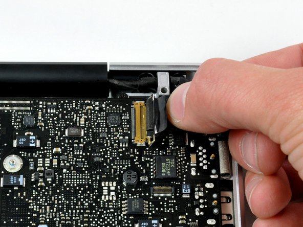

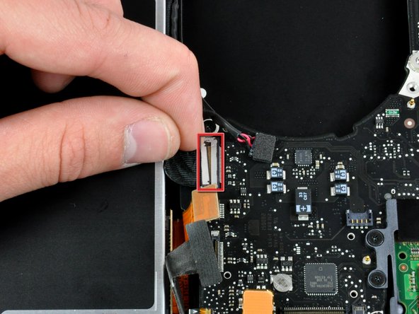

Add Note Edit Step 22  ¶
  • Grab the plastic pull tab secured to the display data cable lock and rotate it toward the DC-in side of the computer.
  • Pull the display data cable connector straight away from its socket.
