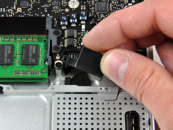

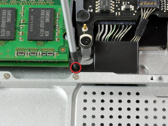

Add Note Edit Step 12  ¶
  • Remove the single Phillips screw securing the battery cable cover to the upper case.
  • Remove the battery cable cover from the upper case.

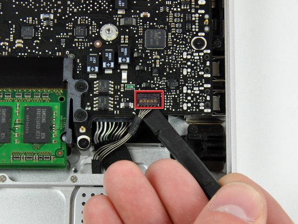

Add Note Edit Step 13  ¶
  • Use a spudger to pry the battery level indicator cable connector straight up off the logic board.
Image #1
Add Note Edit Step 14  ¶
  • Disconnect the battery cable connector by pulling it straight away from the logic board.
  • If you cannot grasp the cable with your fingers, a spudger and tweezers may be helpful for removal.

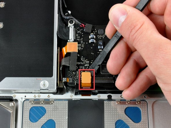

Add Note Edit Step 15  ¶

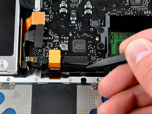

  • Using the tip of a spudger, flip up the keyboard ribbon cable retaining flap.
  • Pull the keyboard ribbon cable straight out of its socket.
Image #1

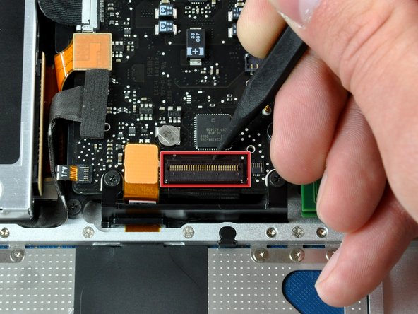

Add Note Edit Step 16  ¶
  • Use the flat end of a spudger to pry the trackpad connector straight up off the logic board.
