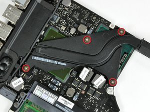

Add Note Edit Step 28 — Heat Sink  ¶
  • Remove the four 8.5 mm Phillips screws securing the heat sink to the logic board.
  • A spring is held under each of these screws.
first image
Add Note Edit Step 29  ¶
  • Use the flat end of a spudger to pry the thermal sensor connector up off the logic board.
first image
Add Note Edit Step 30  ¶
  • Gently lift the heat sink off the logic board.
  • If you need to mount the heat sink back into the laptop, we have a thermal paste guide that makes replacing the thermal compound easy.
