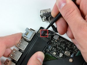

Add Note Edit Step 28 — DC-In Board  ¶
  • Disconnect the DC-In Board connector from the logic board by pulling it straight away from its socket.
