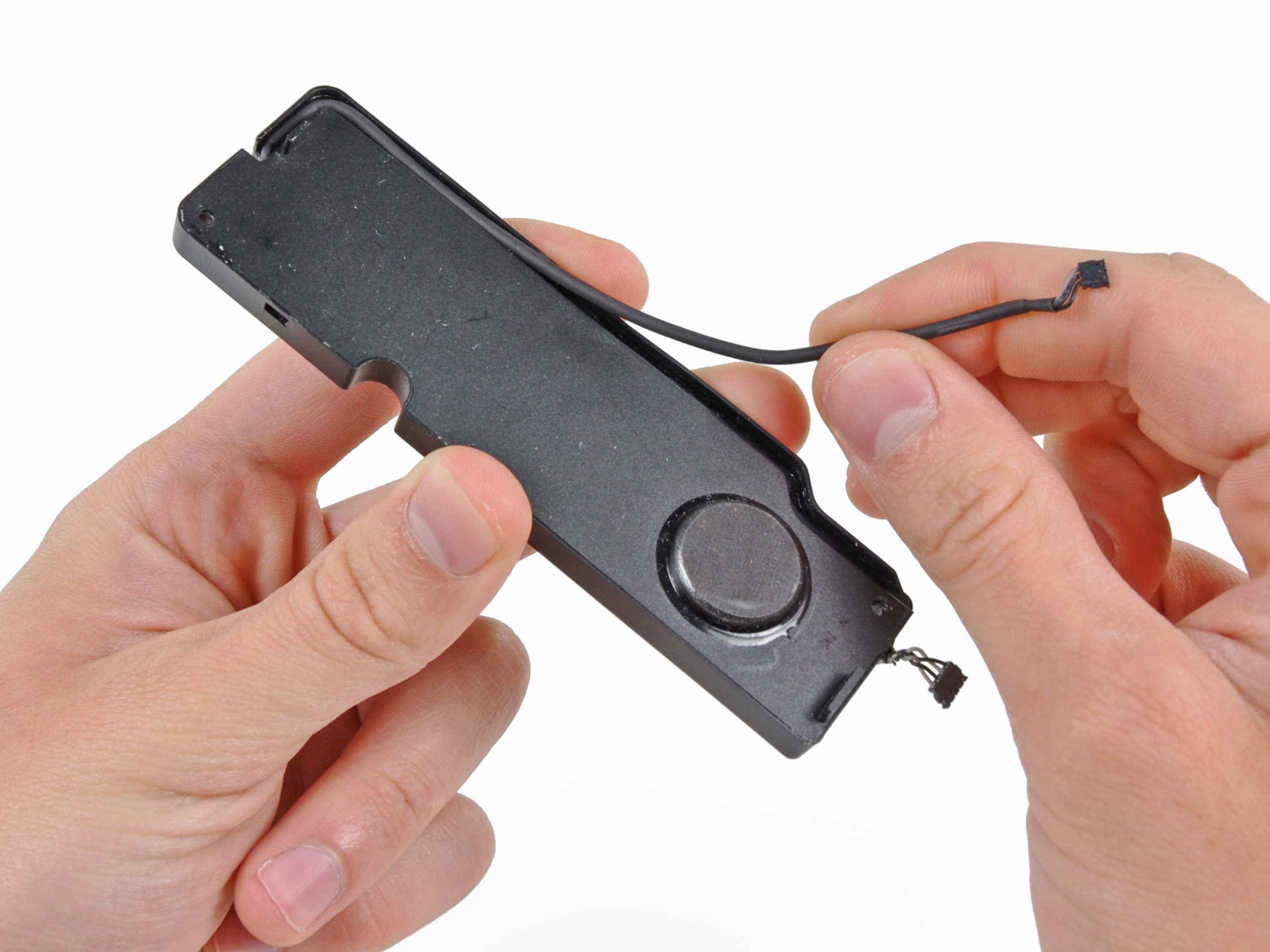

Add Note Edit Step 13  ¶
  • Use the flat end of a spudger to lift the subwoofer & right speaker connector out of its socket on the logic board.
  • Pry up from beneath the wires.
