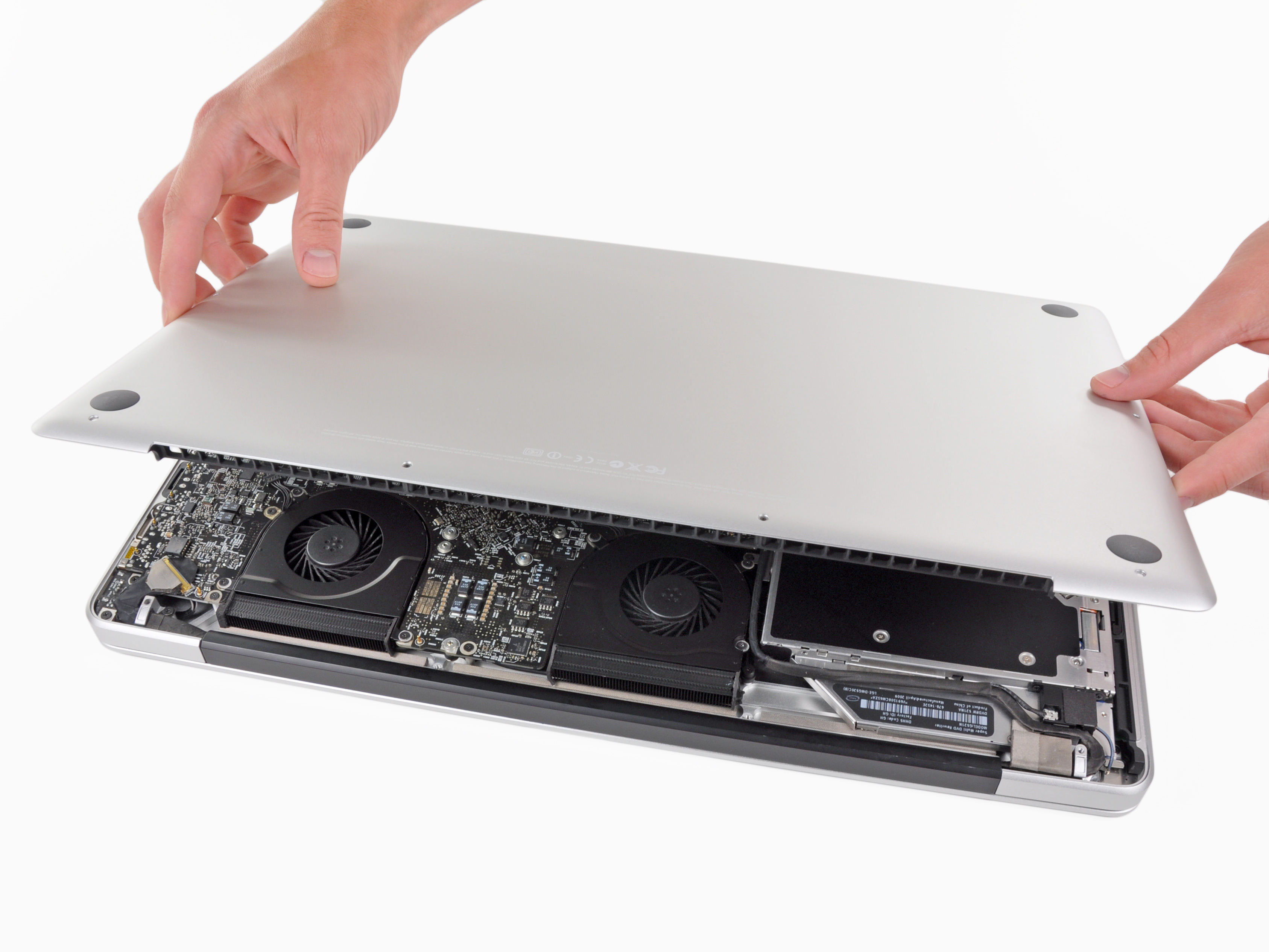

Remove the lower case to access most components in your MacBook Pro 17" Unibody.
first image
    • Seven 3 mm Phillips screws.
first image
thumb image 1
thumb image 2
Add Note Edit Step 2  ¶
  • Wedge your fingers between the lower case and the vent, and lift upward to release the clips holding the lower case to the upper case.
  • Remove the lower case.
