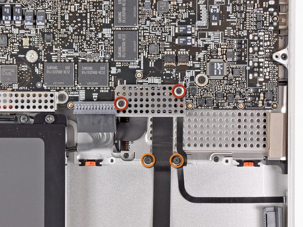

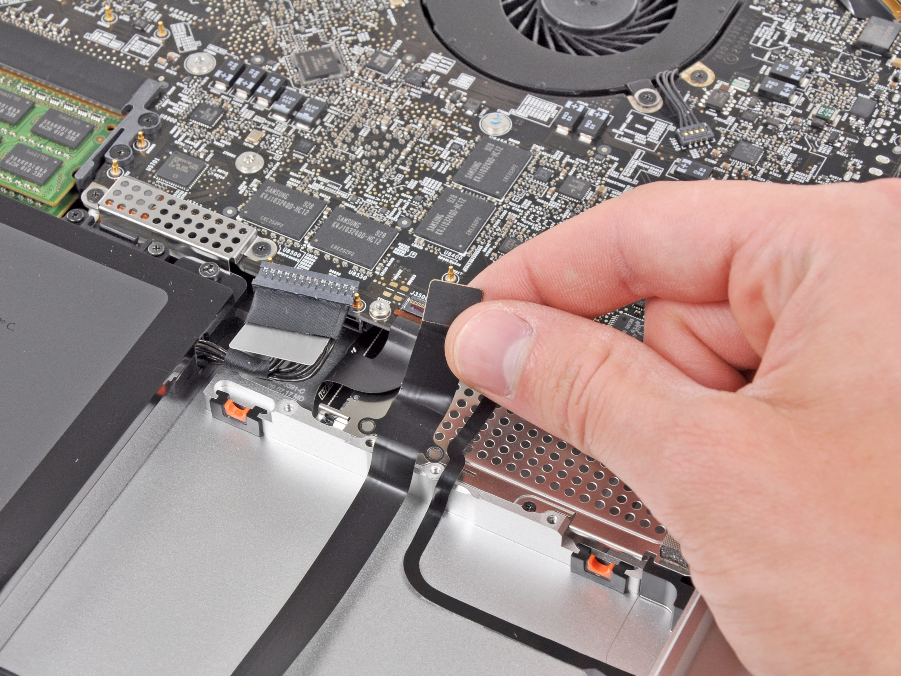

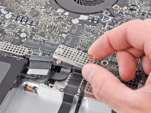

Add Note Edit Step 8 — Hard Drive Cable  ¶
  • Remove the following four screws securing the hard drive cable assembly to the upper case:
    • Two 1.6 mm Phillips screws securing the shield that covers the hard drive cable connector.
    • Two 2.2 mm Phillips screws securing the hard drive cable connector to the upper case.
  • Remove the shield from the logic board.
