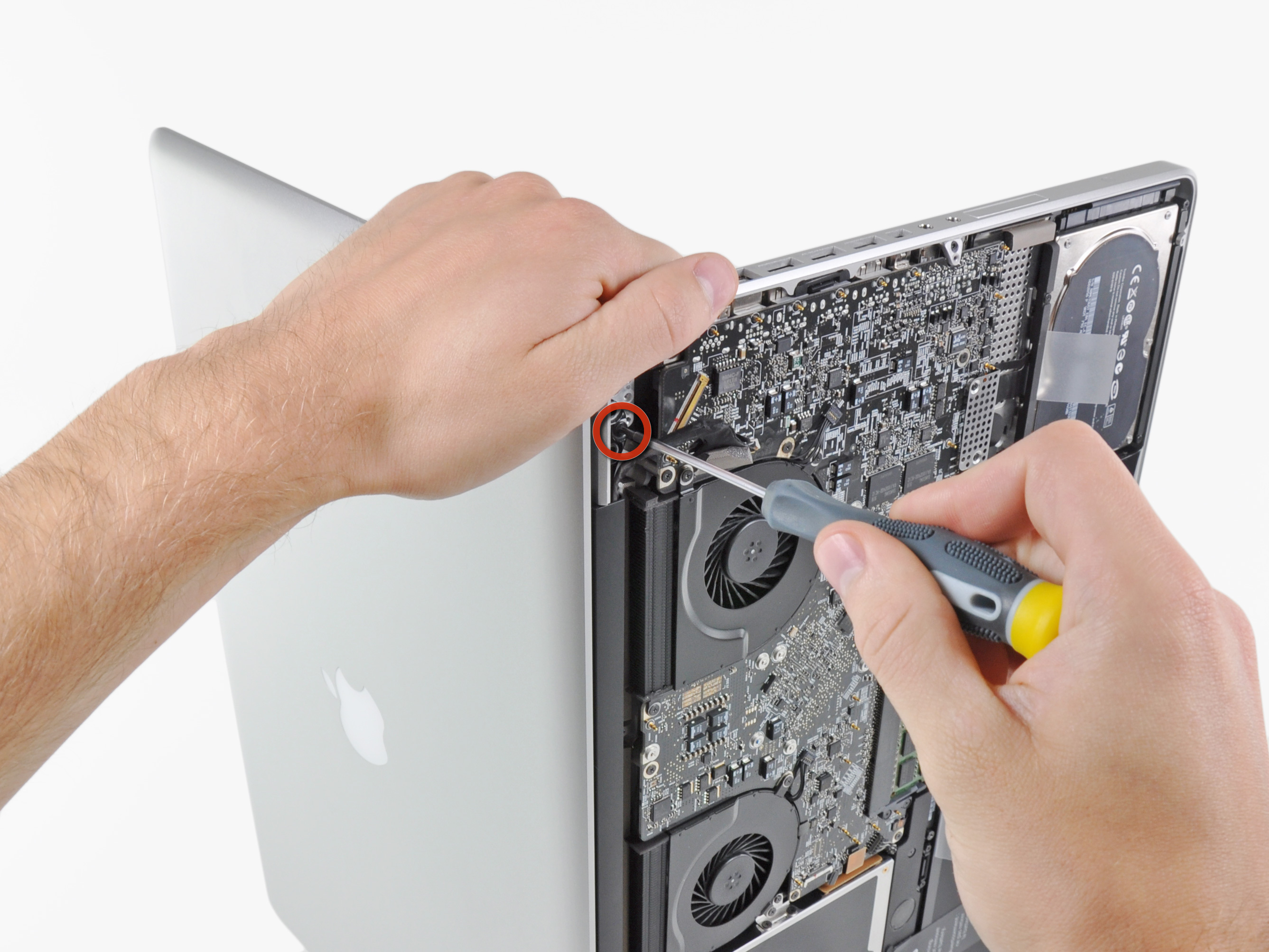

Use this guide to replace your MacBook Pro's display assembly.
first image
    • Seven 3 mm Phillips screws.
first image
thumb image 1
thumb image 2
Add Note Edit Step 2  ¶
  • Wedge your fingers between the lower case and the vent, and lift upward to release the clips holding the lower case to the upper case.
  • Remove the lower case.
first image
thumb image 1
thumb image 2
  • Whenever working near the logic board, it is always wise to first disconnect the battery to avoid short circuits.
  • Grab the plastic tab attached to the battery connector and pull it toward the front edge of the device.
  • Pull the tab parallel to the face of the logic board.
