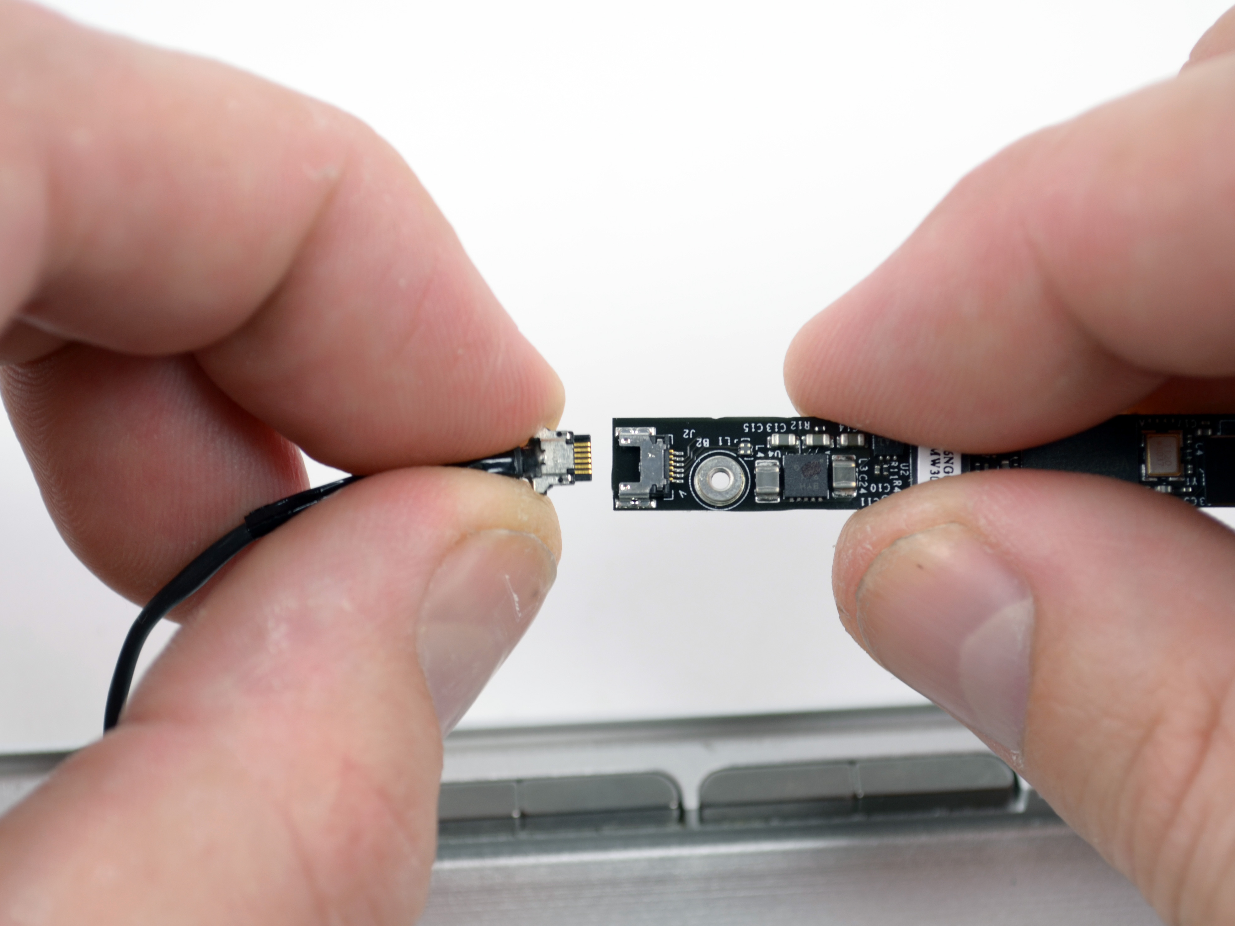

  • Use the flat end of a spudger to peel the thin plastic cover off the top and sides of the Bluetooth board housing.
Image #1
Add Note Edit Step 8  ¶
  • Use the flat end of a spudger to pry the Bluetooth antenna connector up and off its socket on the Bluetooth board.
