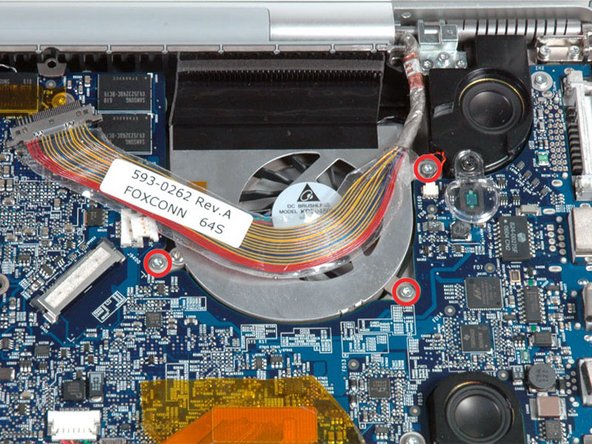

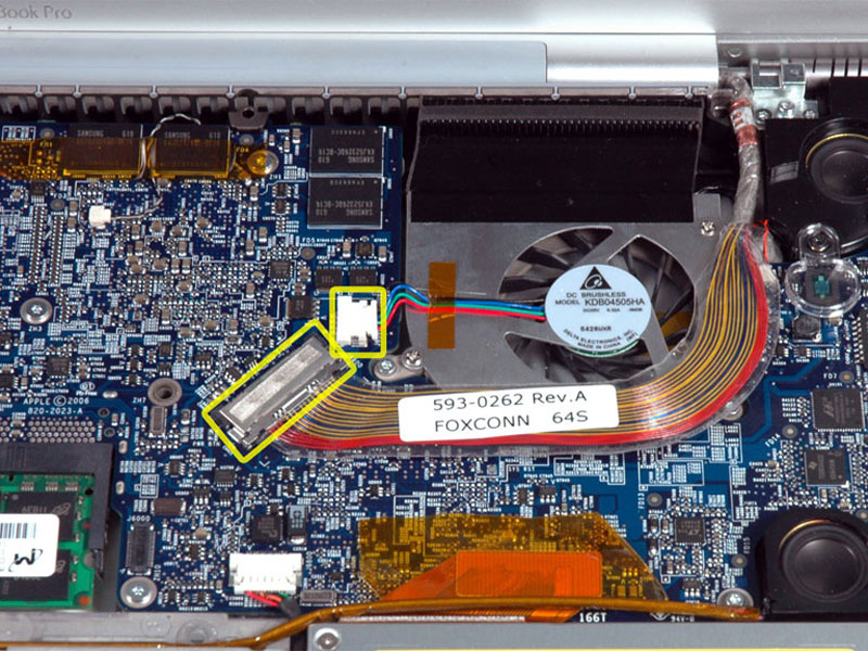

Add Note Edit Step 11 — Right Fan  ¶
  • Disconnect the display data cable and right fan cable from the logic board.
  • If you have a MacBook Pro 17" Model A1229 or A1212, the connectors have different compositions and are highlighted in the second picture.
Image #1
Add Note Edit Step 12  ¶
  • Remove the three silver T6 Torx screws securing the right fan.

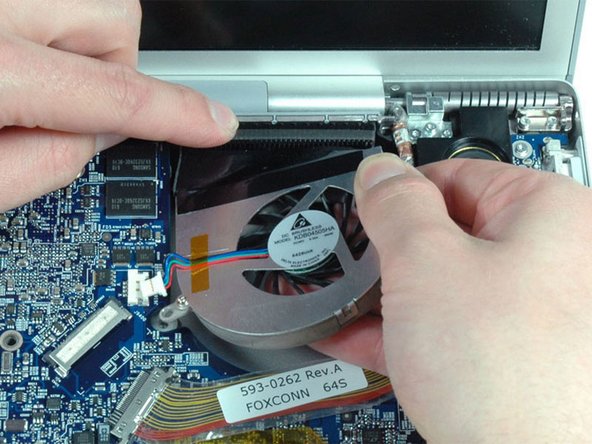

Image #1
Add Note Edit Step 13  ¶
  • Lift the right fan and its metal bracket out of the logic board.
