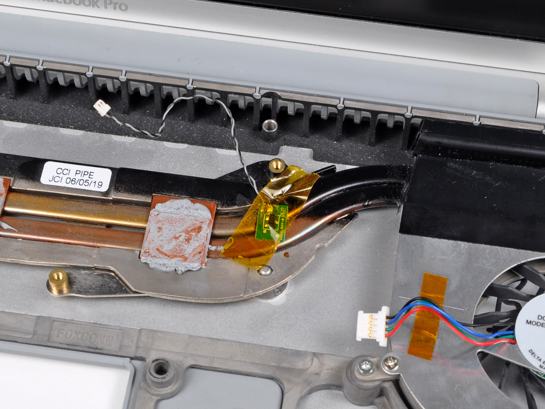

Add Note Edit Step 22 — Left Thermal Sensor  ¶
  • Peel up the orange Kapton tape covering the left thermal sensor.
  • Use a spudger to pry the left thermal sensor off from the heat sink.
For more information, check out the MacBook Pro 17" Models A1151 A1212 A1229 and A1261 device page.
