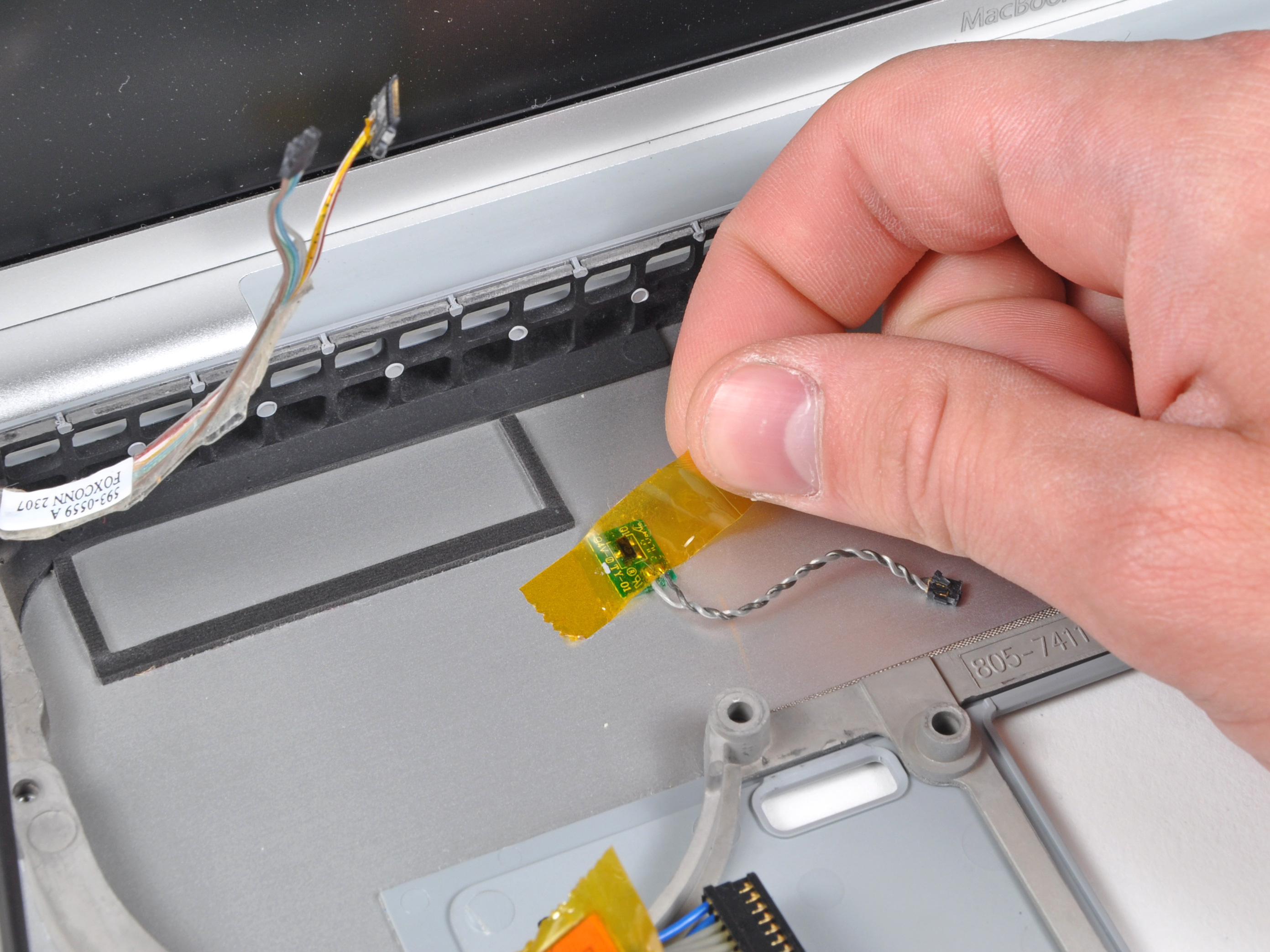

Add Note Edit Step 33 — Left Thermal Sensor (Model A1229)  ¶
  • Peel up the orange Kapton tape covering the left thermal sensor.
  • Use a spudger to pry the left thermal sensor off the lower case.
