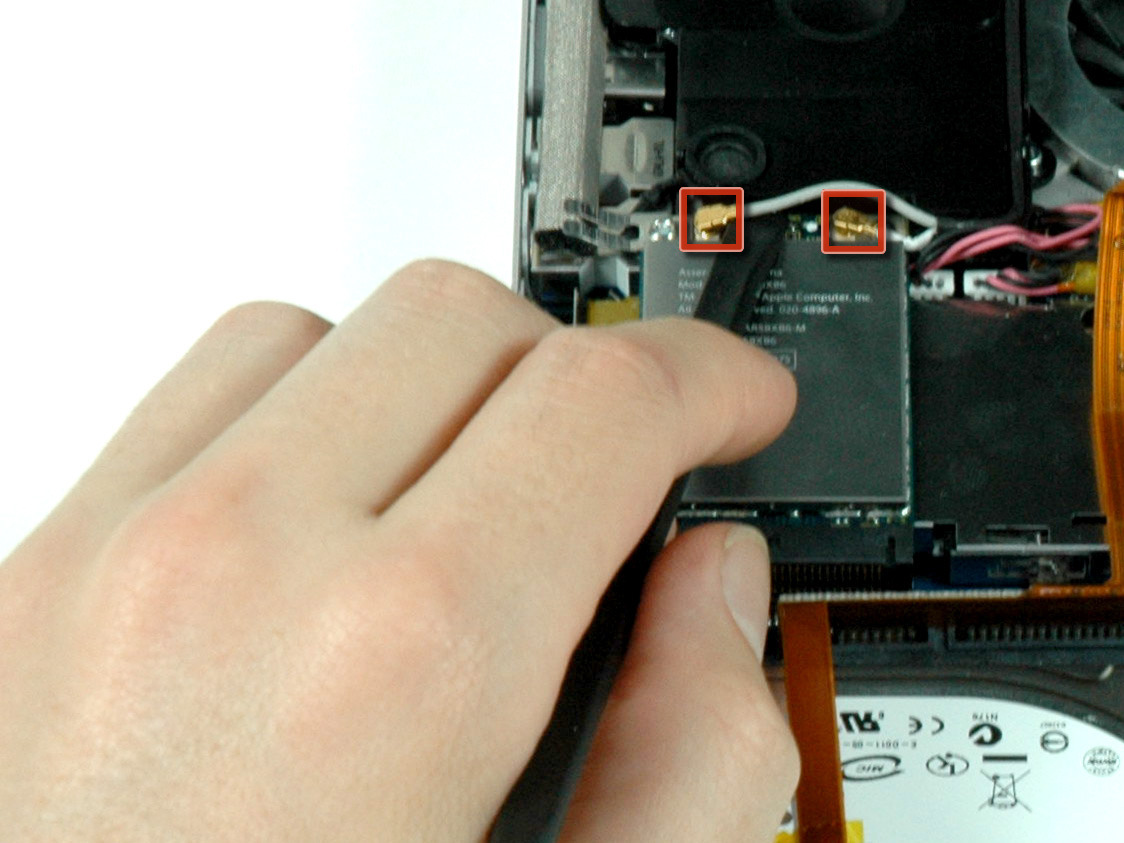

Add Note Edit Step 11 — Left Speaker  ¶
  • Disconnect the two antenna cables attached to the AirPort Extreme card.
  • The cable with the gray shielding attaches to the left side connector, while the cable with the white shielding attaches to the right side.
  • For the A1261 model, The cable with the black shielding attaches to the left side connector, while the cable with the blue shielding attaches to the right side.
  • If you have a MacBook Pro 17" Model A1229 or A1212, there are three antenna cables attached to the AirPort Extreme card instead of two.
first image
