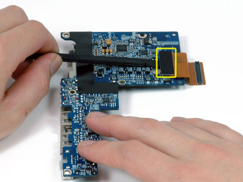

Add Note Edit Step 15  ¶
  • Turn the left I/O board over.
  • Use a spudger to disconnect the short orange cable from the left I/O board.
