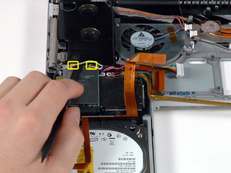

Add Note Edit Step 22 — Heat Sink  ¶
  • Disconnect the two antenna cables attached to the AirPort Extreme card.
  • The cable with the gray shielding attaches to the left side connector, while the cable with the white shielding attaches to the right side.
  • If you have a MacBook Pro 17" Model A1229, there are three antenna cables attached to the AirPort Extreme card instead of two.
first image
