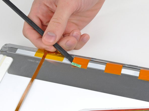

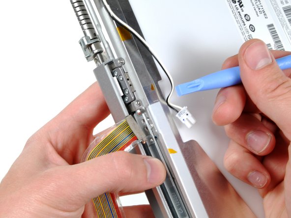

Add Note Edit Step 25 — Clutch Assembly  ¶
  • Use the flat end of a spudger to carefully peel off the three antenna straps stuck to the lower edge of the LCD.

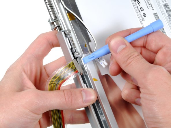

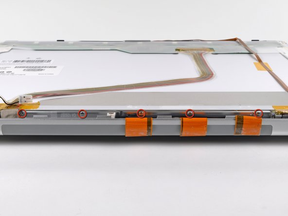

Add Note Edit Step 26  ¶
  • Remove the five Phillips screws securing the clutch cover to the bottom edge of the front display bezel.

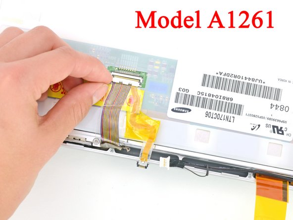

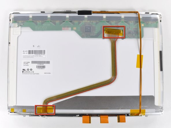

Add Note Edit Step 27  ¶
  • Remove the two pieces of tape securing the display data cable to the LCD.
Image #1 Image #2

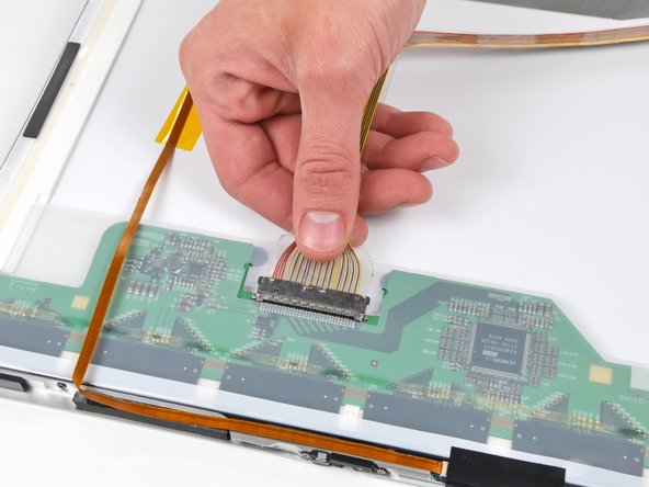

Add Note Edit Step 28  ¶
  • Disconnect the display data cable from the LCD by pulling it toward the bottom edge of the display.

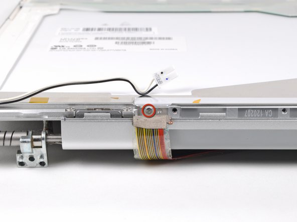

Add Note Edit Step 29  ¶
  • Move the display data cable out of the way to remove the Phillips screw hidden underneath.

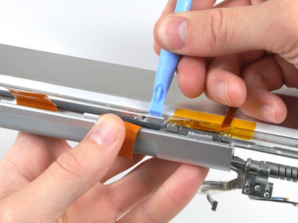

Add Note Edit Step 30  ¶
  • While pulling the clutch assembly away from the clutch hinge with one hand, insert an iPod opening tool between the clutch cover and the front display bezel to lift the clutch cover over the retaining pin on the front display bezel.
  • Pull the clutch assembly away from the front display bezel.

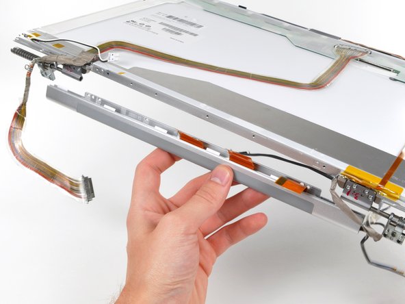

Add Note Edit Step 32  ¶
  • Remove the clutch assembly from the front display bezel, minding any cables that may get caught.
