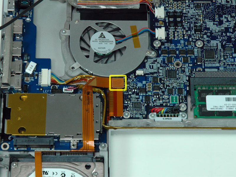

Add Note Edit Step 17 — ExpressCard Cage  ¶
  • Disconnect the hard drive ribbon cable and the left I/O board ribbon cable from the logic board.
  • Disconnect the right speaker connector from the left I/O board.
first image

Add Note Edit Step 20  ¶
  • Move the orange hard drive ribbon out of the way with one hand. Use your other hand to lift up the right side of the left I/O board and slide it out of the computer.
first image
