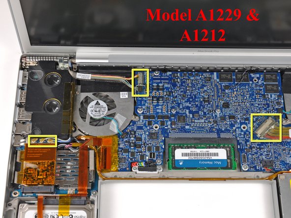

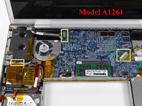

Add Note Edit Step 11 — Display  ¶
  • Disconnect the two antenna cables from the AirPort Extreme card, the iSight and inverter cables from the left side of the logic board, and the display data cable from the right side of the logic board.
  • For A1229 and A1212 models, disconnect the three antenna cables from the AirPort Extreme card and the three connectors highlighted on the logic board.
  • For the A1229, the order of the cables from left to right is: Black (left; towards the edge of the case) — Grey (middle) — Blue (right; towards the middle of the case.
  • For the A1261 model, disconnect the two antenna cables from the AirPort Extreme card and the three connectors highlighted on the logic board.
  • Carefully peel the iSight and inverter cables off the top of the left fan and de-route the AirPort antenna cables from the channel in the left speaker.

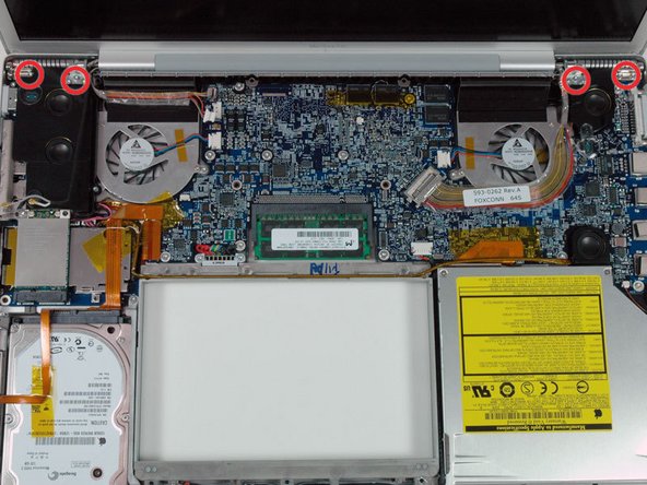

Add Note Edit Step 12  ¶
  • Remove the ten silver T6 Torx screws securing the display (five on each side-take note that the inside screws on both sides are longer with a thinner head).
  • Don't forget to replace the hinge end caps when reinstalling the display assembly. The end caps are side specific, so be sure that the posts are facing towards the lower case.

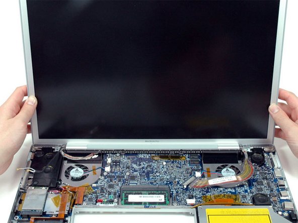

Add Note Edit Step 13  ¶
  • Grasp the display assembly on both sides and lift it up and out of the computer.

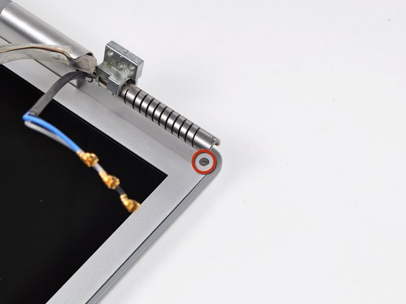

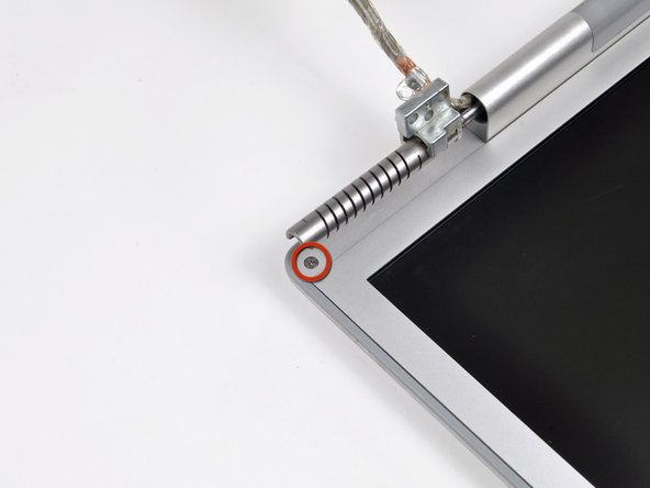

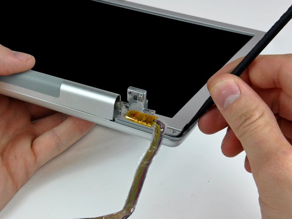

Add Note Edit Step 14 — Rear Display Bezel  ¶
  • The hinge end caps on this model can be easily removed at this point, as they are not fastened to the hinge and may fall off during service.
  • Remove the Phillips screws from the lower left and right corners of the display (two screws total).
Image #1 Image #2 Image #3

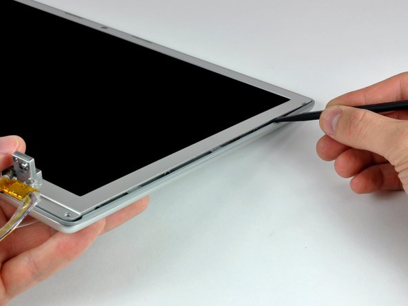

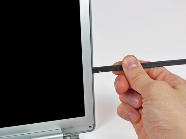

Add Note Edit Step 15  ¶
  • Insert the flat end of a spudger perpendicular to the face of the display between the plastic strip attached to the rear bezel and the front bezel.
  • Do not insert your spudger between the plastic strip and the rear bezel.
  • With the spudger still inserted, rotate it away from the display to separate the front and rear bezels.
  • Work along the right edge of the display until the rear bezel is evenly separated from the front bezel.

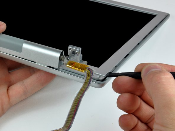

Image #1 Image #2

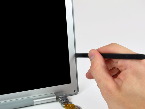

Add Note Edit Step 16  ¶
  • Insert your spudger between the front and rear display bezels at the lower right corner of the display.
  • Pry the rear bezel away from the front bezel to slightly separate the bottom edge of the rear display bezel.
