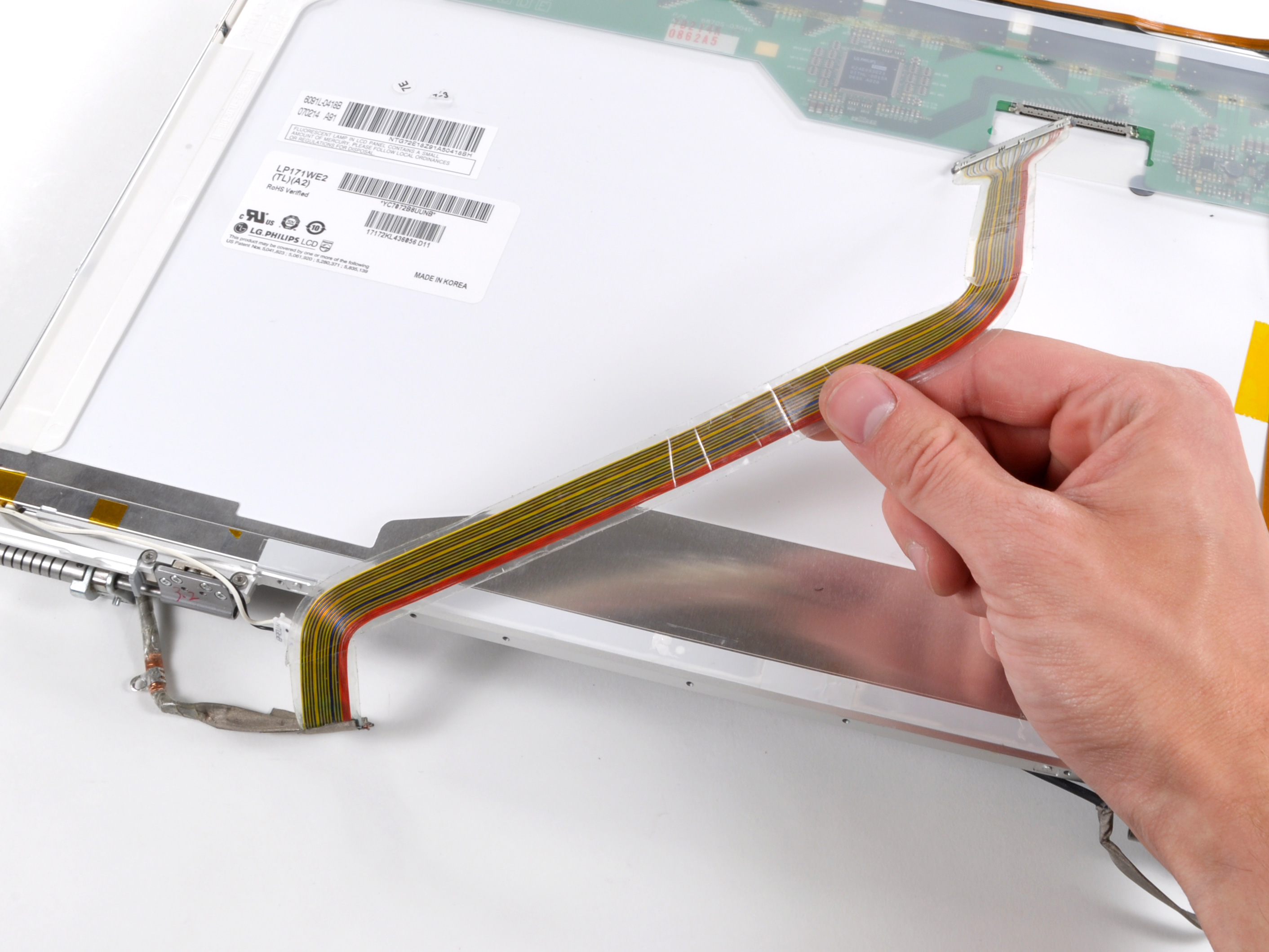

  • Remove the two pieces of tape securing the display data cable to the LCD.
first image
Add Note Edit Step 28  ¶
  • Disconnect the display data cable from the LCD by pulling it toward the bottom edge of the display.
first image

Add Note Edit Step 33 — Display Data Cable  ¶
  • Remove the display data cable from the display assembly.
