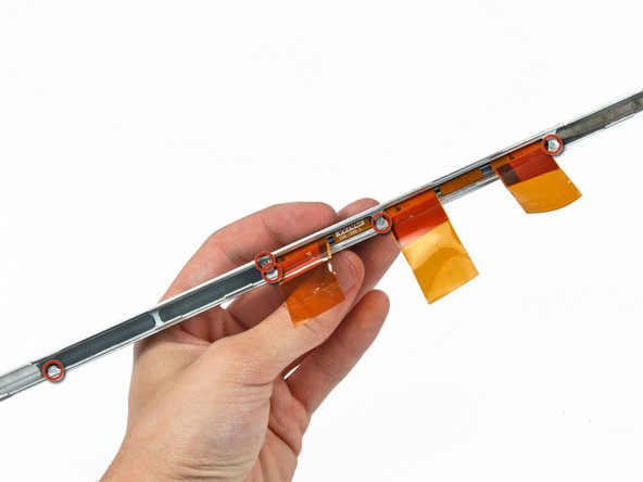

Add Note Edit Step 25 — Antenna Cover  ¶
  • Remove the five small Phillips screws securing the plastic antenna cover to the inside of the clutch cover.
Image #1

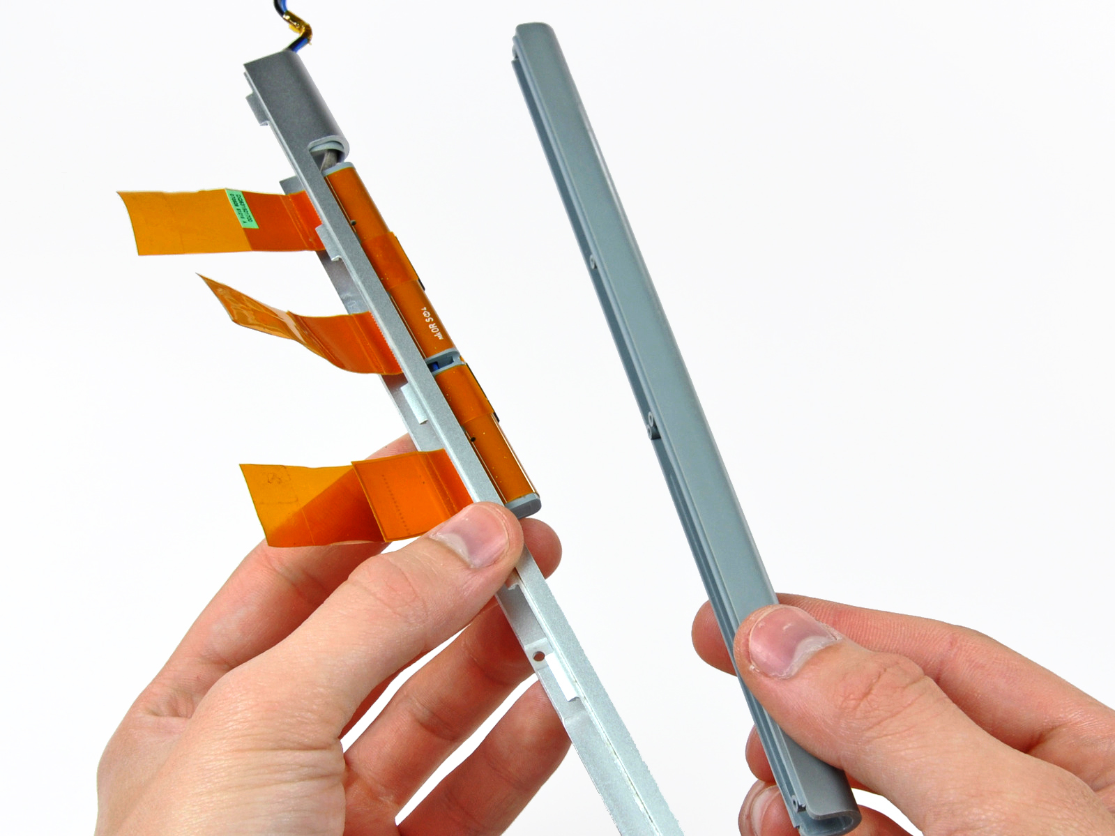

Add Note Edit Step 26  ¶
  • Pull the antenna cover off the clutch cover, being careful not to damage the antenna cables.
