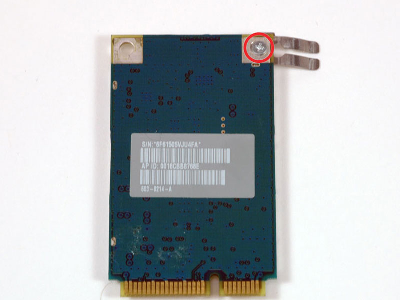

Use this guide to replace a broken AirPort Extreme card.
first image
  • Use your fingers to push both battery release tabs away from the battery and lift the battery out of the computer.
first image
Add Note Edit Step 2 — RAM Shield  ¶
  • Remove the four identical Phillips screws from the memory door.
first image
Add Note Edit Step 3  ¶
  • Lift the memory door up enough to get a grip on it, and slide it toward you, pulling it away from the casing.
