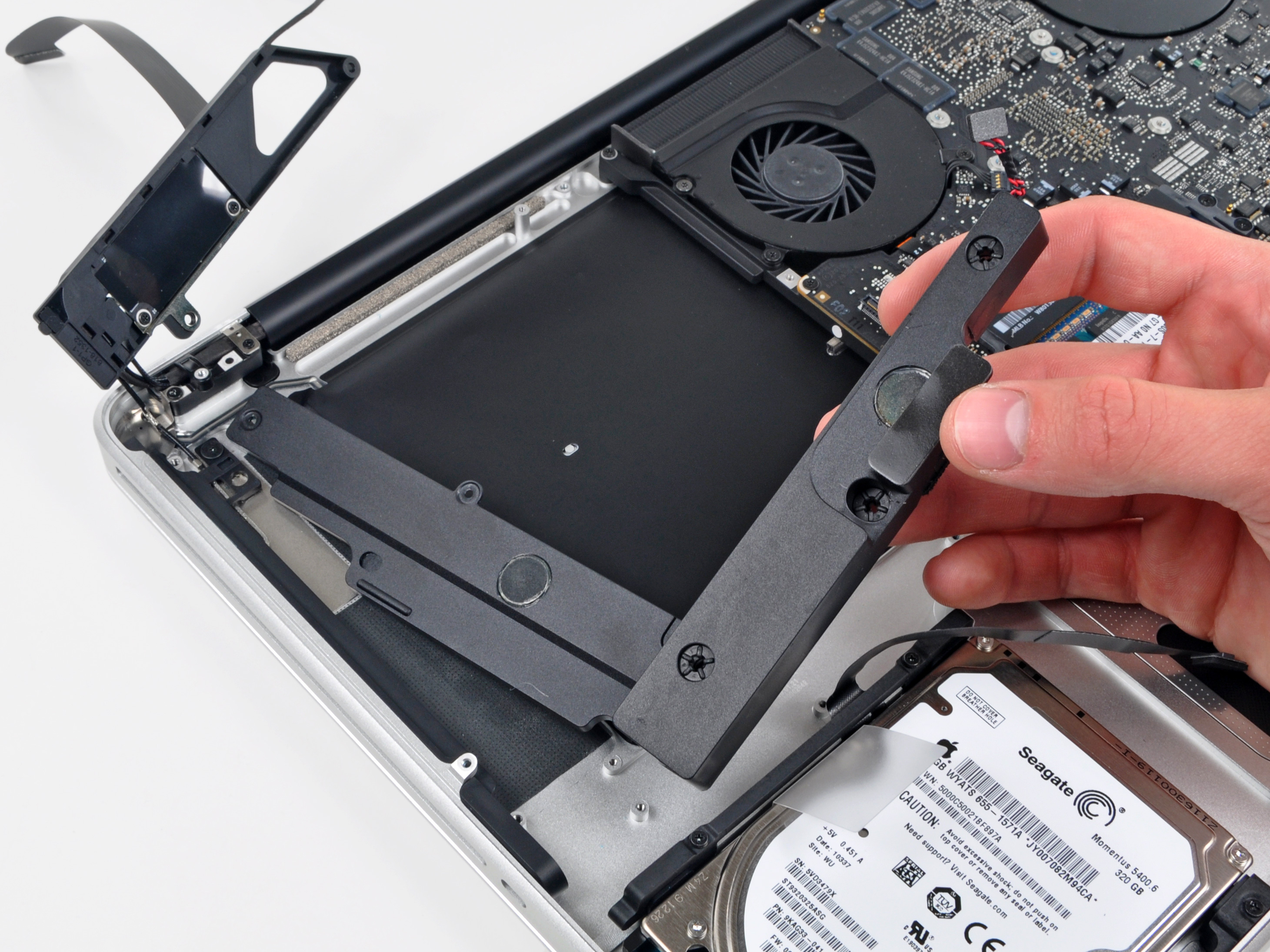

Installing MacBook Pro 15" Unibody Mid 2010 Subwoofer & Right Speaker
Replace the subwoofer & right speaker in your Mid 2010 MacBook Pro 15" Unibody.
  • Add Note x
  • x 4
Is the right side of your MacBook Pro mute? Use this guide to replace the subwoofer & right speaker assembly.
Image #1
    • Three 13.5 mm (14.1 mm) Phillips screws.
    • Seven 3 mm Phillips screws.
Image #1
Add Note Edit Step 2  ¶
  • Using both hands, lift the lower case near the vent to pop it off two clips securing it to the upper case.
Image #1
  • Remove the two 7.4 mm Y1 Tri-Wing screws securing the battery to the upper case.
  • Note: For certain repairs (e.g. hard drive), removing the battery is not necessary but it prevents any accidental shorting of electronics on the motherboard. If you do not remove the battery, please be careful as parts of the motherboard might be electrified.
  • You do not necessarily have to follow steps 3-6 to remove the battery in order to replace the hard drive. However it is recommended to remove all power sources from electronics before working on them.
Image #1
Add Note Edit Step 4  ¶
  • Use the tip of your finger to carefully peel back the corner of the warning label to reveal a hidden Tri-Wing screw.
  • Remove the last 7.4 mm Y1 Tri-Wing screw securing the battery to the upper case.
Image #1 Image #2
Add Note Edit Step 5  ¶
  • Lift the battery by its plastic pull tab and slide it away from the long edge of the upper case.
  • Do not try to completely remove the battery just yet.
Image #1
Add Note Edit Step 6  ¶
  • Tilt the battery away from the logic board enough to access the battery cable connector.
  • Pull the battery cable connector away from its socket on the logic board and remove the battery from the upper case.
  • Pull the battery cable connector away from the center of the logic board.
Image #1
Add Note Edit Step 7 — Optical Drive  ¶
  • Use the flat end of a spudger to pry the AirPort/Bluetooth ribbon cable connector up off the logic board.
Image #1
Add Note Edit Step 8  ¶
  • Disconnect the camera cable by pulling its connector away from the socket on the logic board.
