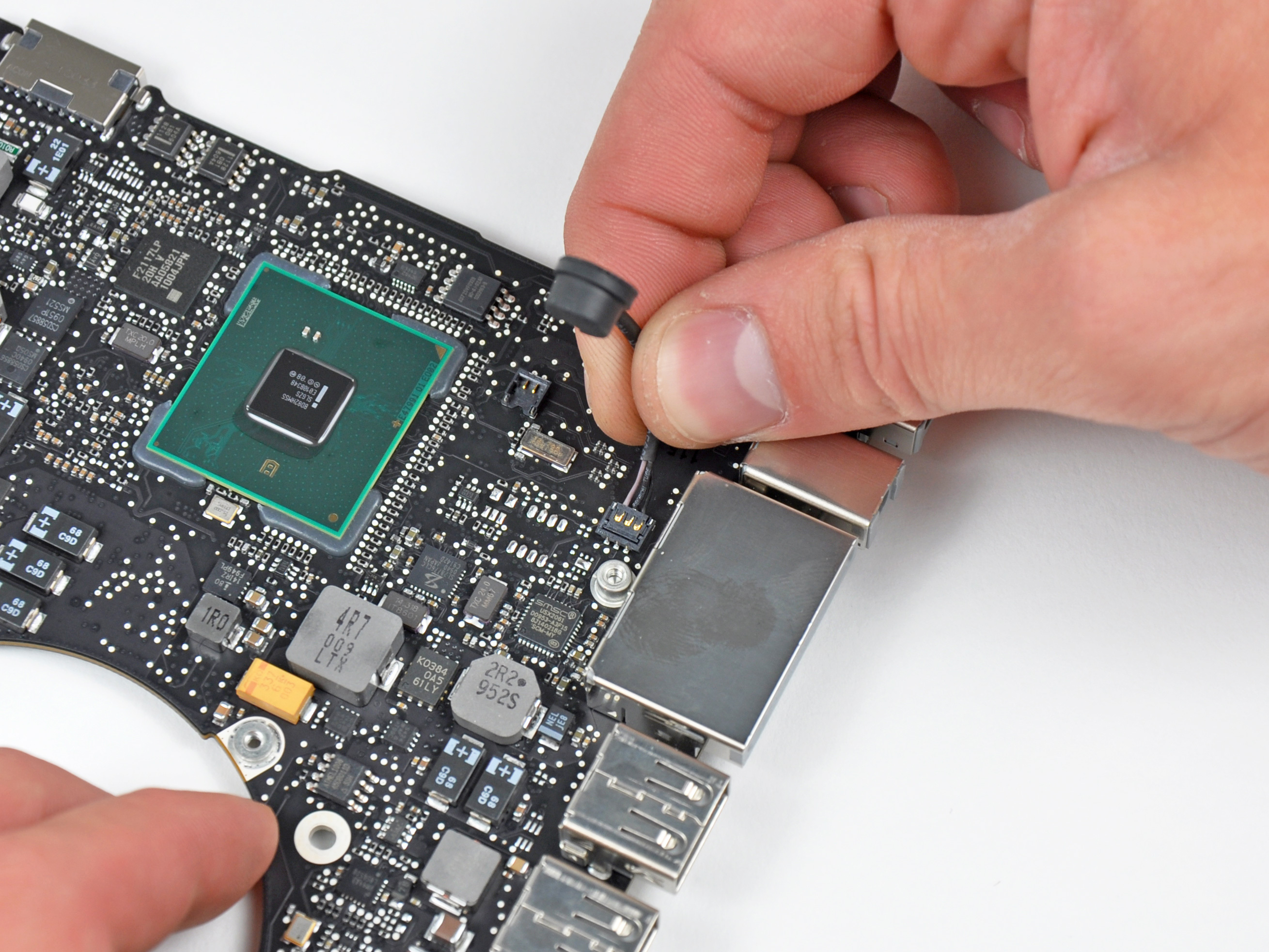

Add Note Edit Step 30 — Microphone  ¶
  • Carefully pull the microphone cables upward to lift the microphone connector out of its socket on the logic board.
