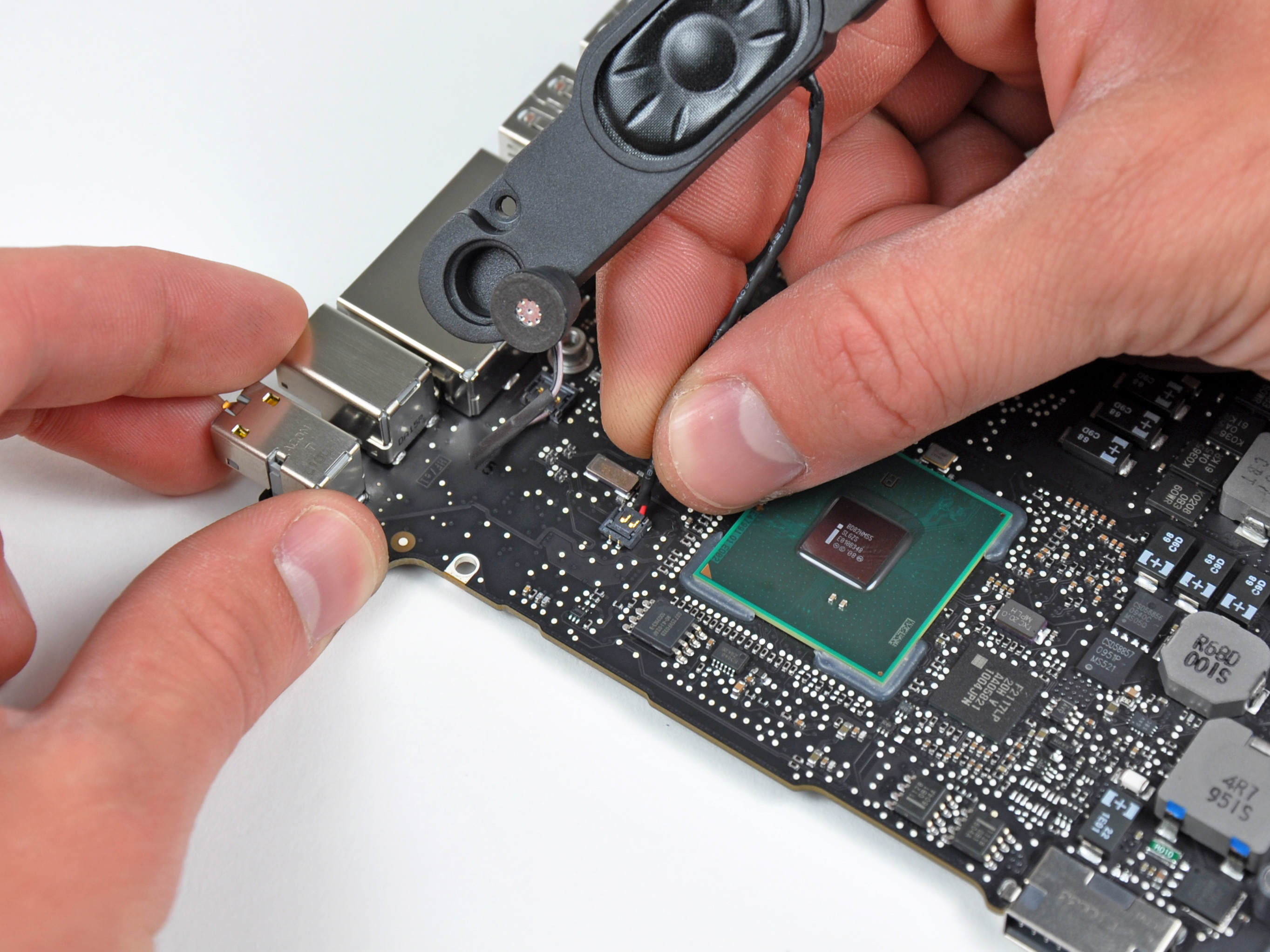

Add Note Edit Step 27 — Left Speaker  ¶
  • Lift the microphone out of its recess in the left speaker housing.
first image
Add Note Edit Step 28  ¶
  • Remove the two 5 mm Phillips screws securing the left speaker to the logic board.
first image
Add Note Edit Step 29  ¶
  • If present, remove the small strip of black tape covering the left speaker connector.
  • Carefully pull the left speaker wires upward to lift the left speaker connector out of its socket on the logic board.
