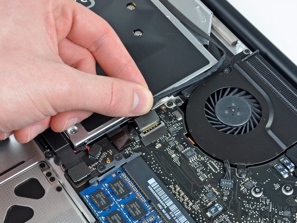

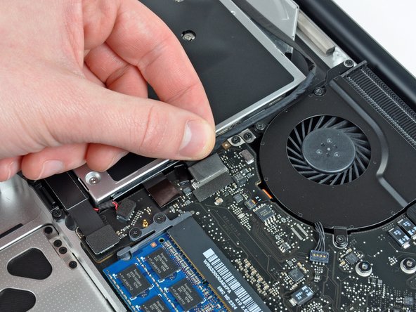

  • Use the flat end of a spudger to pry the hard drive/IR sensor cable connector up off the logic board.
  • Peel the hard drive cable up from the channel within the subwoofer and right speaker.
first image

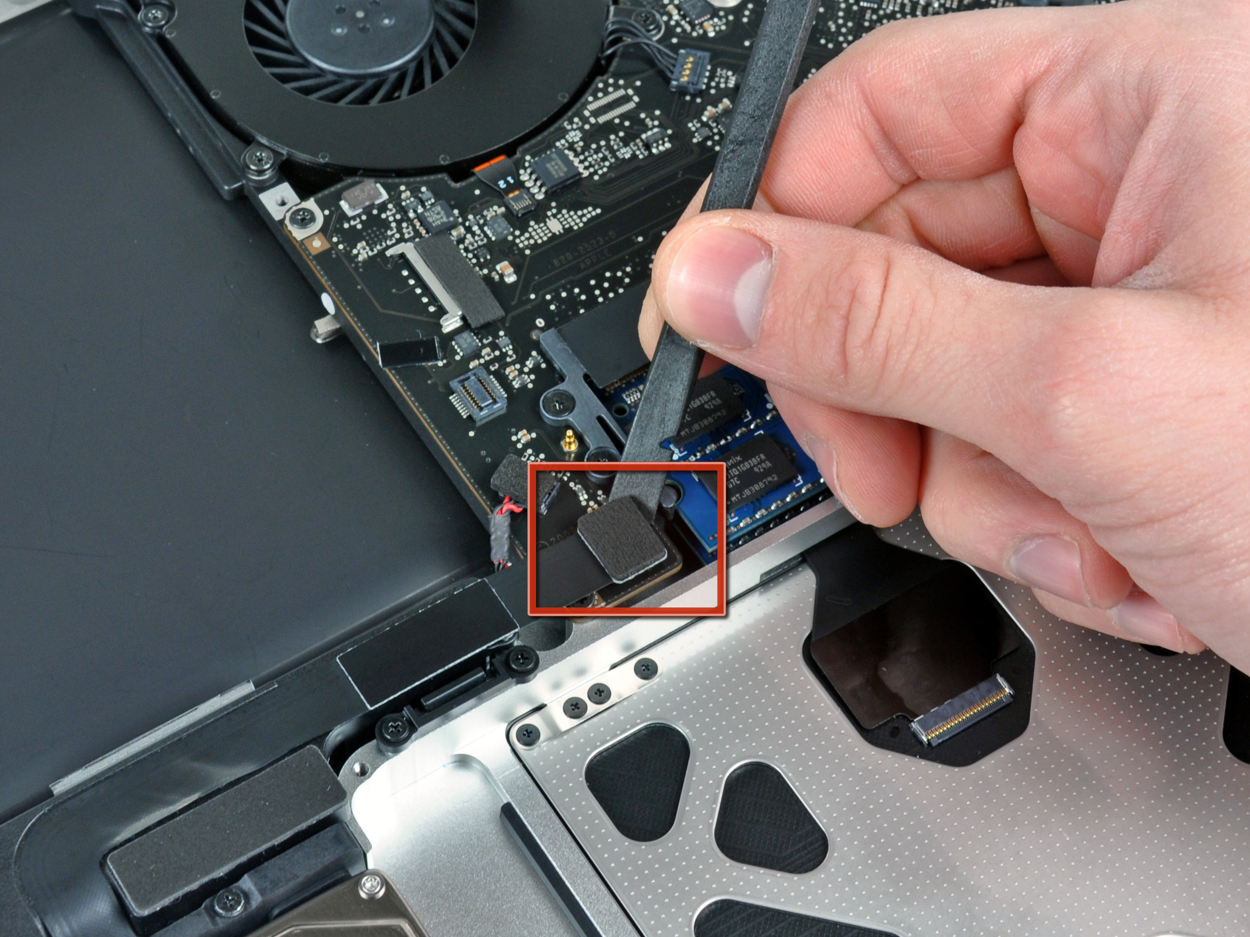

Add Note Edit Step 17  ¶
  • Using the flat end of a spudger, pry the subwoofer/right speaker connector straight up off the logic board.
first image
