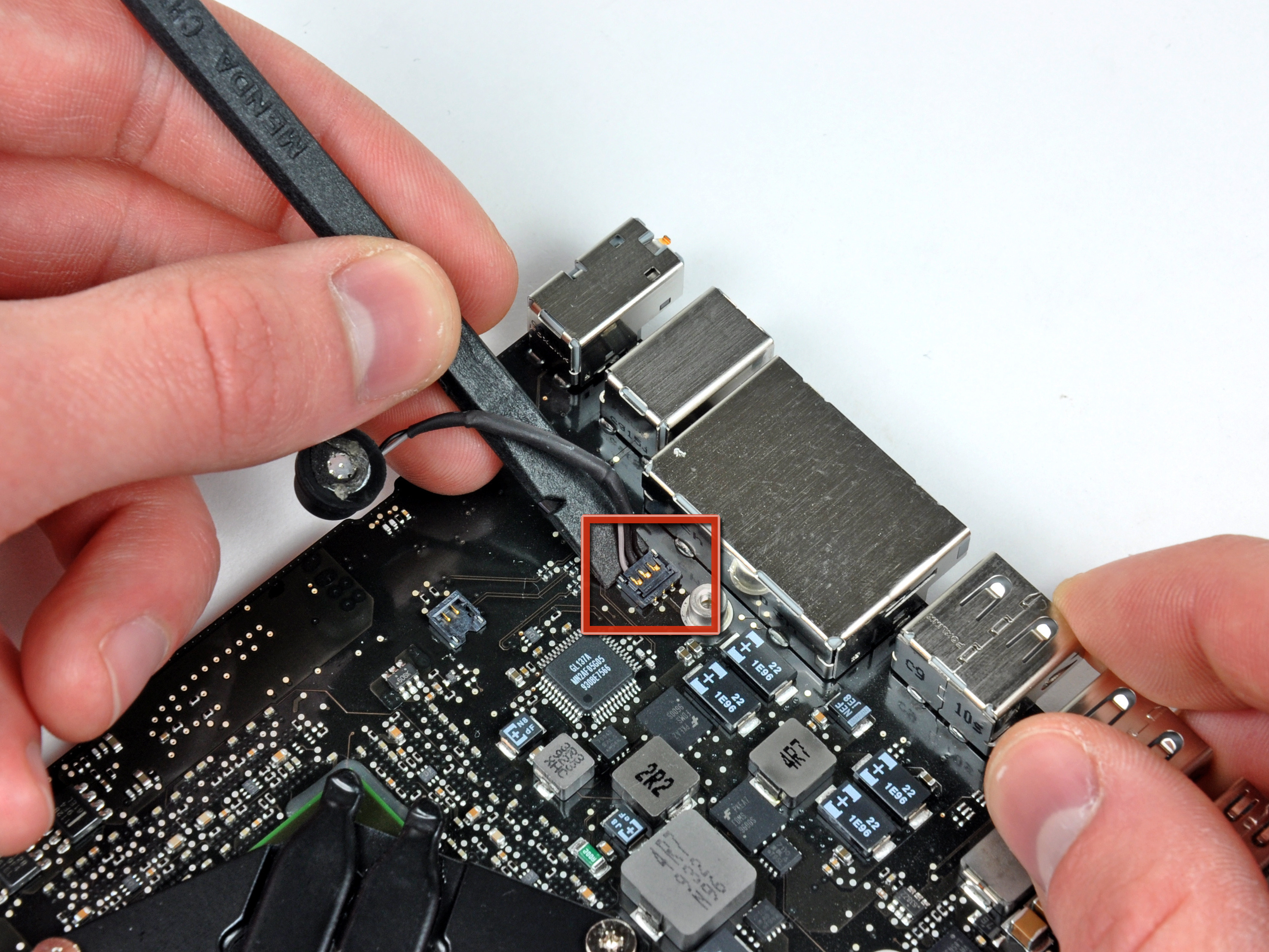

Add Note Edit Step 32 — Microphone  ¶
  • Use the flat end of a spudger to pry the microphone cable connector up off its socket on the logic board.
  • Pry up from beneath the wires.
