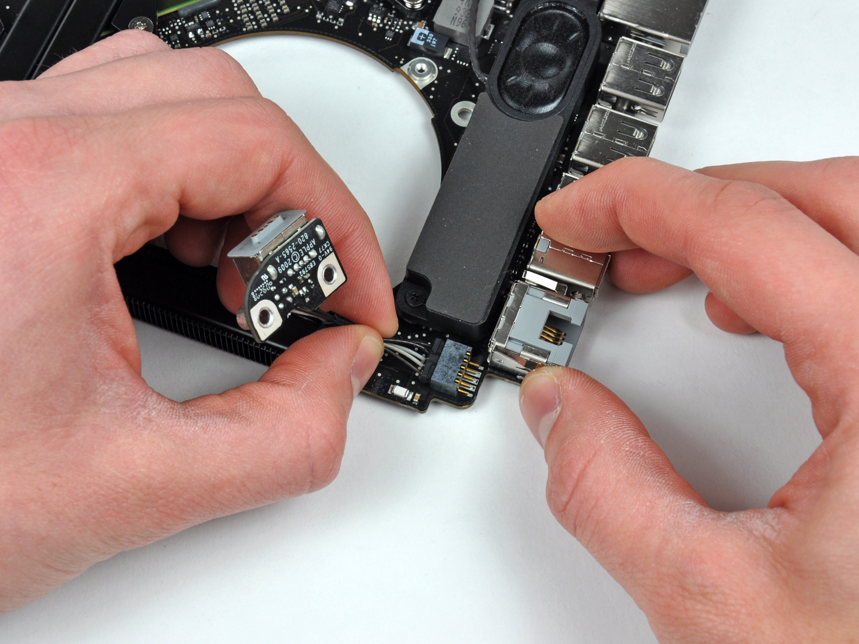

Add Note Edit Step 28 — MagSafe DC-In Board  ¶
  • Lay the logic board on a soft flat surface with the heat sink facing up.
  • Disconnect the DC-In Board connector from the logic board by pulling it straight away from its socket.
