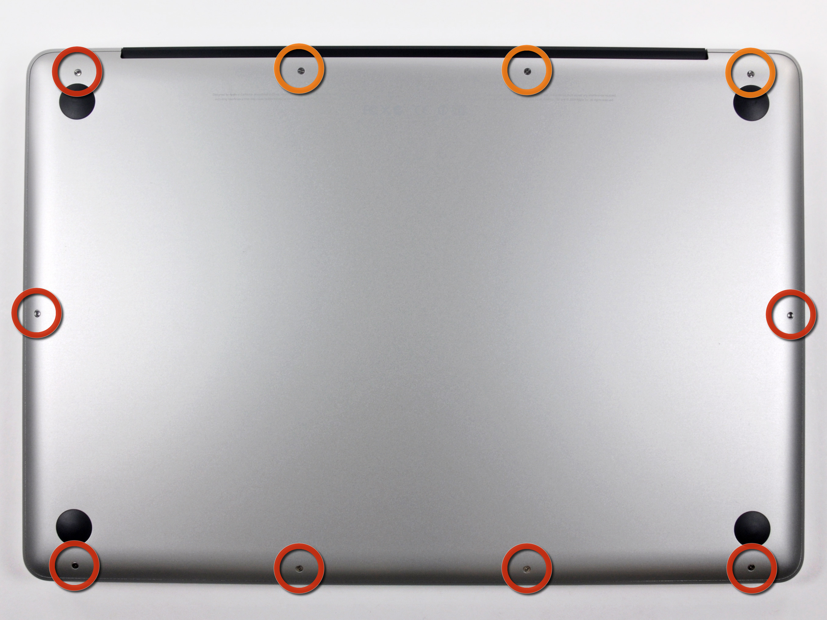

Remove the lower case to access most of your MacBook Pro's internals.
first image
    • Seven 3 mm Phillips screws.
first image
thumb image 1
thumb image 2
Add Note Edit Step 2  ¶
  • Using both hands, lift the lower case near the vent to pop it off two clips securing it to the upper case.
