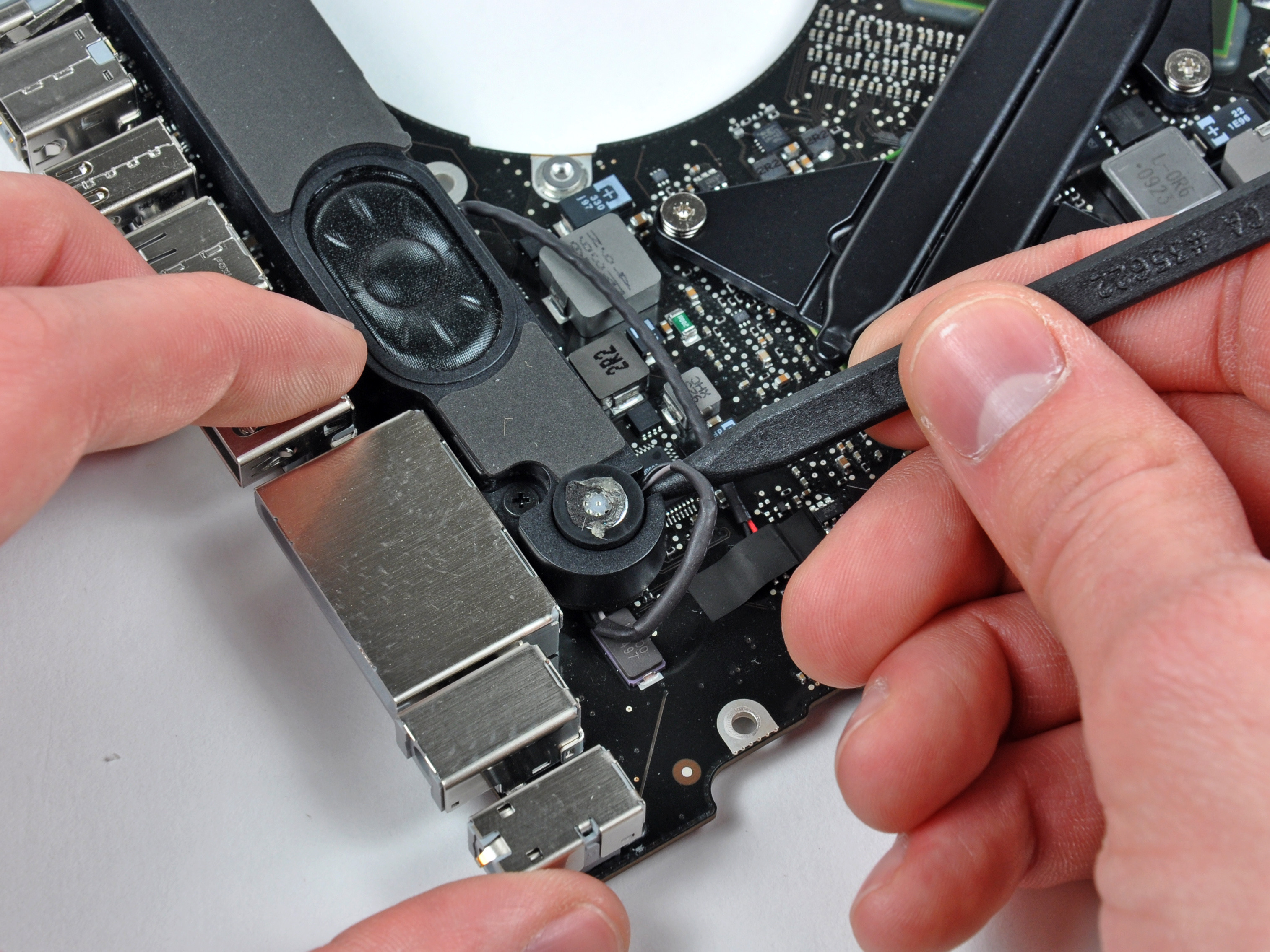

Add Note Edit Step 28 — Left Speaker  ¶
  • If your microphone is still inserted into its void in the left speaker housing, use the tip of a spudger to lift it out.
first image
Add Note Edit Step 29  ¶
  • Remove the small strip of tape covering the left speaker connector.
first image
Add Note Edit Step 30  ¶
  • Use the flat end of a spudger to pry the left speaker connector up off its socket on the logic board.
  • Pry up from beneath the wires.
first image
thumb image 1
thumb image 2
Add Note Edit Step 31  ¶
  • Remove the two 5 mm Phillips screws securing the left speaker to the logic board.
  • Lift the left speaker off the logic board.
