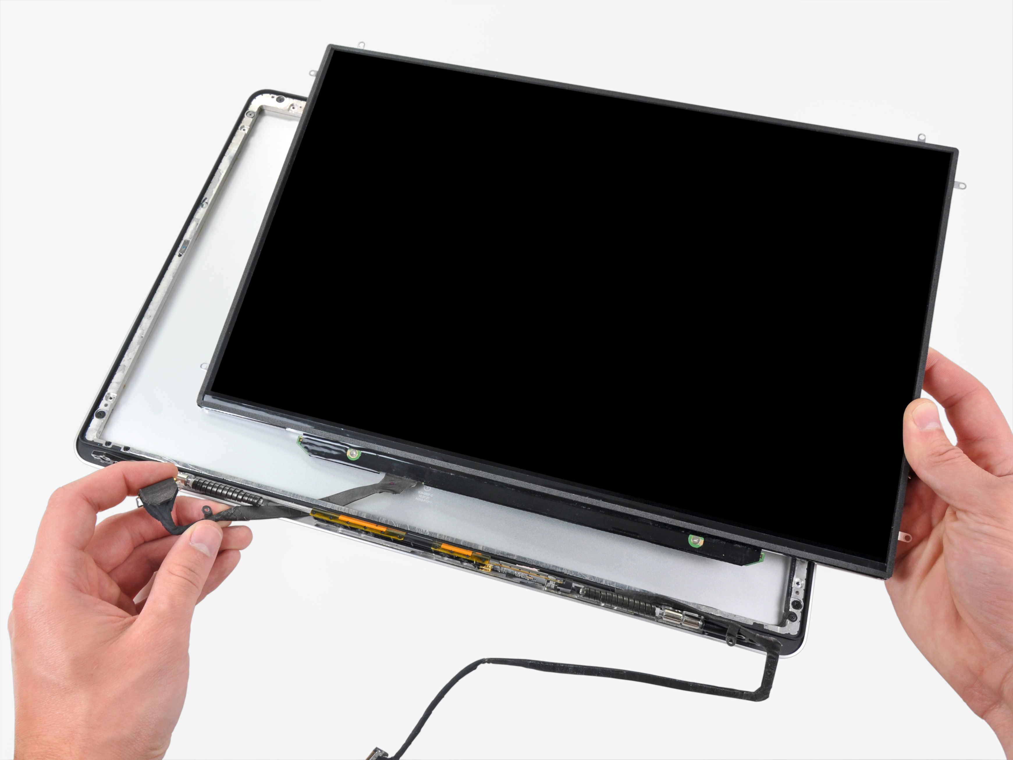

Add Note Edit Step 7 — Display  ¶
  • Apple sticks a small strip of clear plastic with adhesive applied to one side of the logic board behind the camera cable connector to keep it in its socket. When moving it out of the way, be sure not to break any surface-mount components off the logic board.
  • Use the tip of a spudger to rotate the plastic retainer away from the camera cable connector.
Image #1 Image #2
Add Note Edit Step 8  ¶
  • Pull the camera cable away from its socket on the logic board.
  • Pull the connector parallel to the face of the logic board, not straight up.
