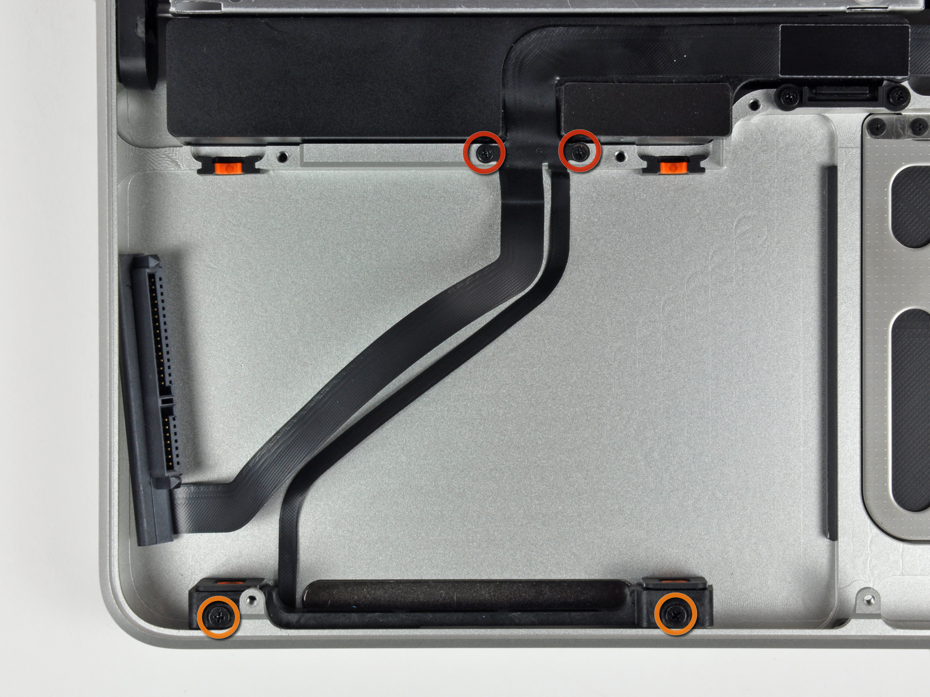

The hard drive cable includes the IR sensor/sleep indicator.
first image
    • Seven 3 mm Phillips screws.
first image
