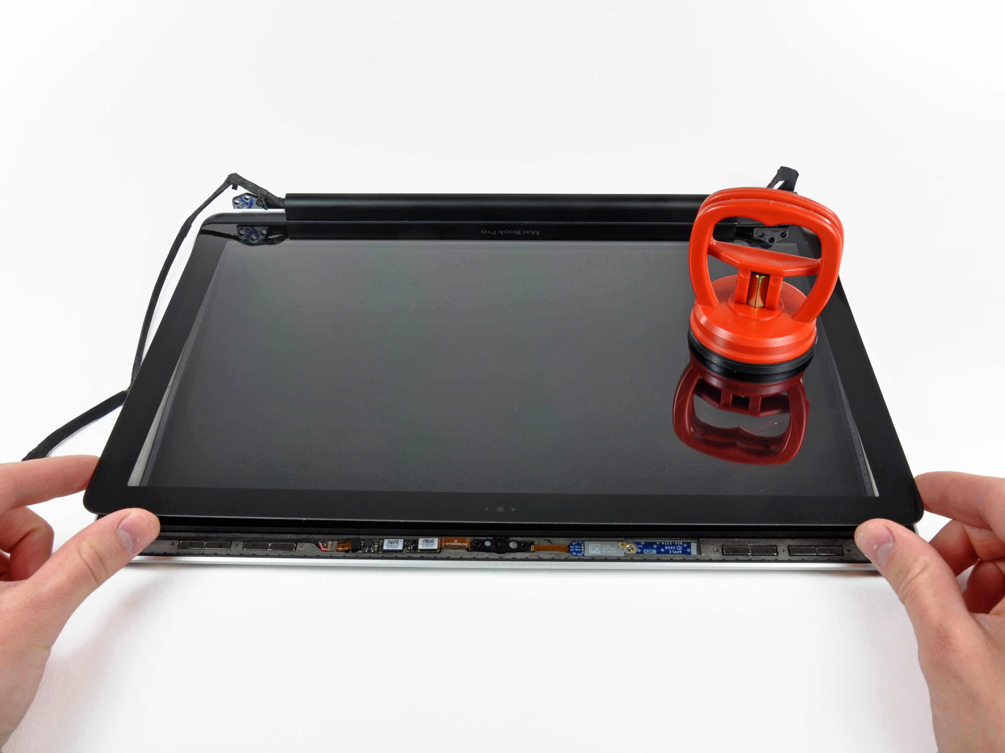

Installing MacBook Pro 15" Unibody Mid 2009 Front Display Glass
Replacing the front display glass.
  • Add Note x
Use this guide to replace a broken front display glass panel. Removal of the front display glass is required to access the LCD. Although it is not technically necessary to remove the display to access the front display glass, it greatly simplifies the task. This guide is not applicable for anti-glare displays.
