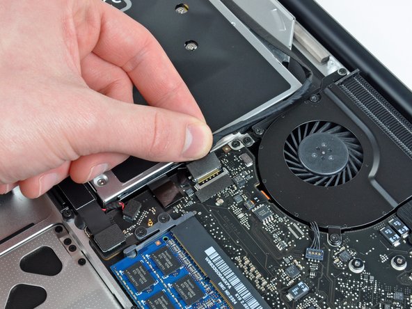

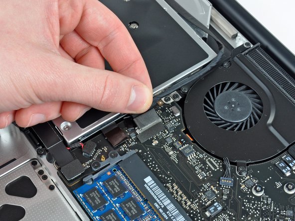

  • Using both hands, lift the lower case near the vent to pop it off two clips securing it to the upper case.
first image
  • Three special five-point Torx screws secure the battery to the upper case.
  • Use Apple specialty tool 922-9101 or iFixit's 5-point Torx driver to remove the two exposed five-point Torx security screws along the top edge of the battery.
  • A common 1.5 mm flathead screwdriver also works well enough to remove the screws.
  • You do not necessarily have to follow steps 3-6 to remove the battery in order to replace the hard drive. However it is recommended to remove all power sources from electronics before working on them.
