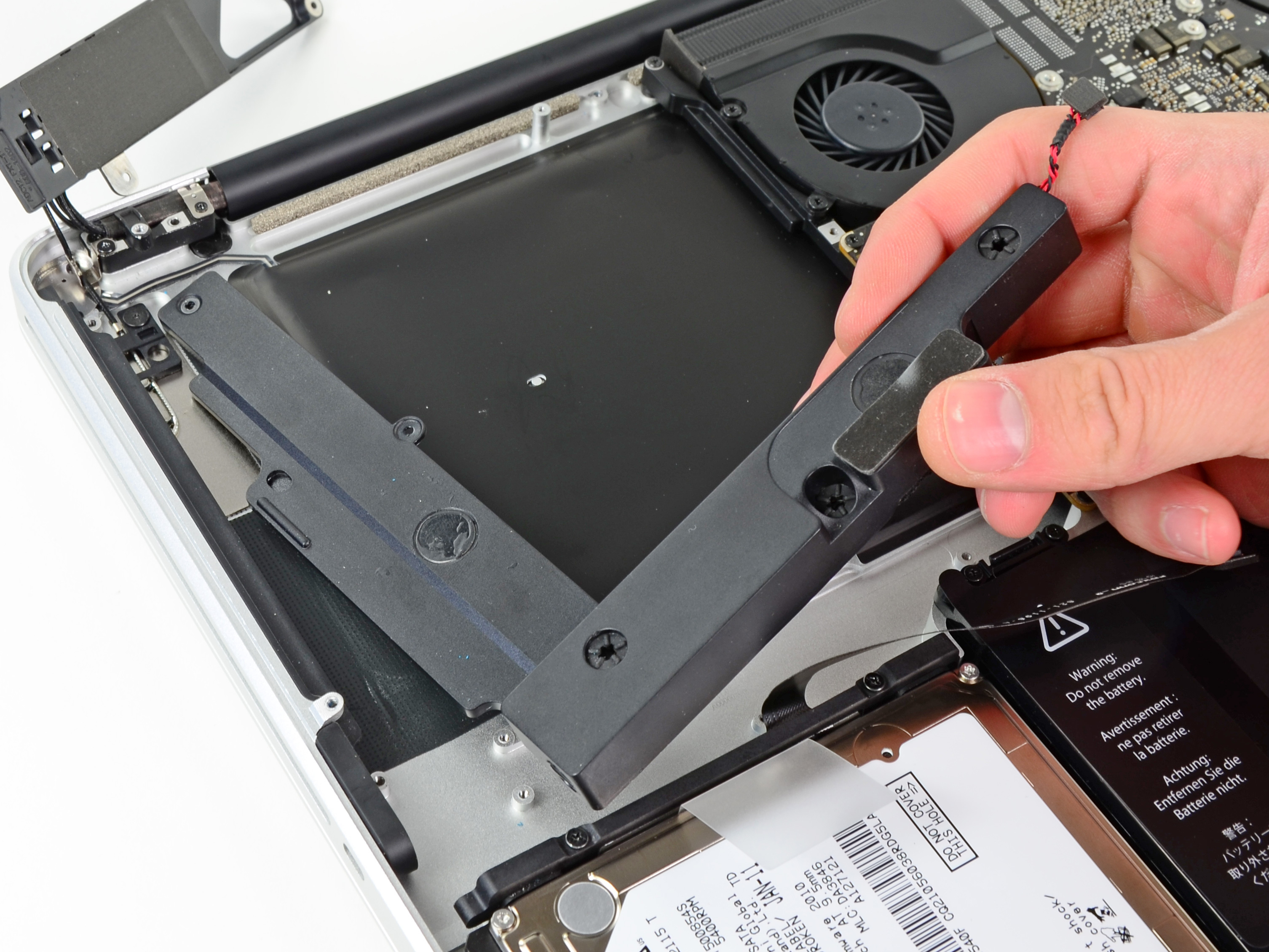

Installing MacBook Pro 15" Unibody Late 2011 Subwoofer & Right Speaker
Replace the subwoofer & right speaker on your Late 2011 MacBook Pro 15" Unibody.
Has the right side of your MacBook Pro gone mute? Use this guide to replace the subwoofer & right speaker assembly.
Image #1
    • Three 13.5 mm (14.1 mm) Phillips screws.
    • Seven 3 mm Phillips screws.
Image #1
Add Note Edit Step 2  ¶
  • Using both hands, lift the lower case near the vent to pop it off two clips securing it to the upper case.
Image #1 Image #2
Add Note Edit Step 3 — Battery Connector  ¶
  • For certain repairs (e.g. hard drive), disconnecting the battery connector is not necessary but it prevents any accidental shorting of electronics on the motherboard. If you do not disconnect the battery connector, please be careful as parts of the motherboard might be electrified.
  • Use the edge of a spudger to pry the battery connector upwards from its socket on the logic board.
  • It is useful to pry upward on both short sides of the connector to "walk" it out of its socket.
Image #1
Add Note Edit Step 4  ¶
  • Bend the battery cable slightly away from its socket on the logic board so it does not accidentally connect itself while you work.
Image #1
Add Note Edit Step 5 — Optical Drive  ¶
  • Disconnect the camera cable connector from its socket on the logic board.
  • Do not lift up on the cable as you disconnect it from the logic board. Pull the cable parallel to the face of the logic board.
Image #1
Add Note Edit Step 6  ¶
  • Use the flat end of a spudger to pry the AirPort/Bluetooth connector up from its socket on the logic board.
Image #1
Add Note Edit Step 7  ¶
  • Use the flat end of a spudger to pry the optical drive connector up from its socket on the logic board.
Image #1 Image #2
Add Note Edit Step 8  ¶
  • Remove following two screws:
    • One 8.6 mm Phillips screw
    • One 3.9 mm Phillips screw
  • Carefully rotate the AirPort/Bluetooth board housing (with AirPort/Antenna cables still attached) out of the lower case.
