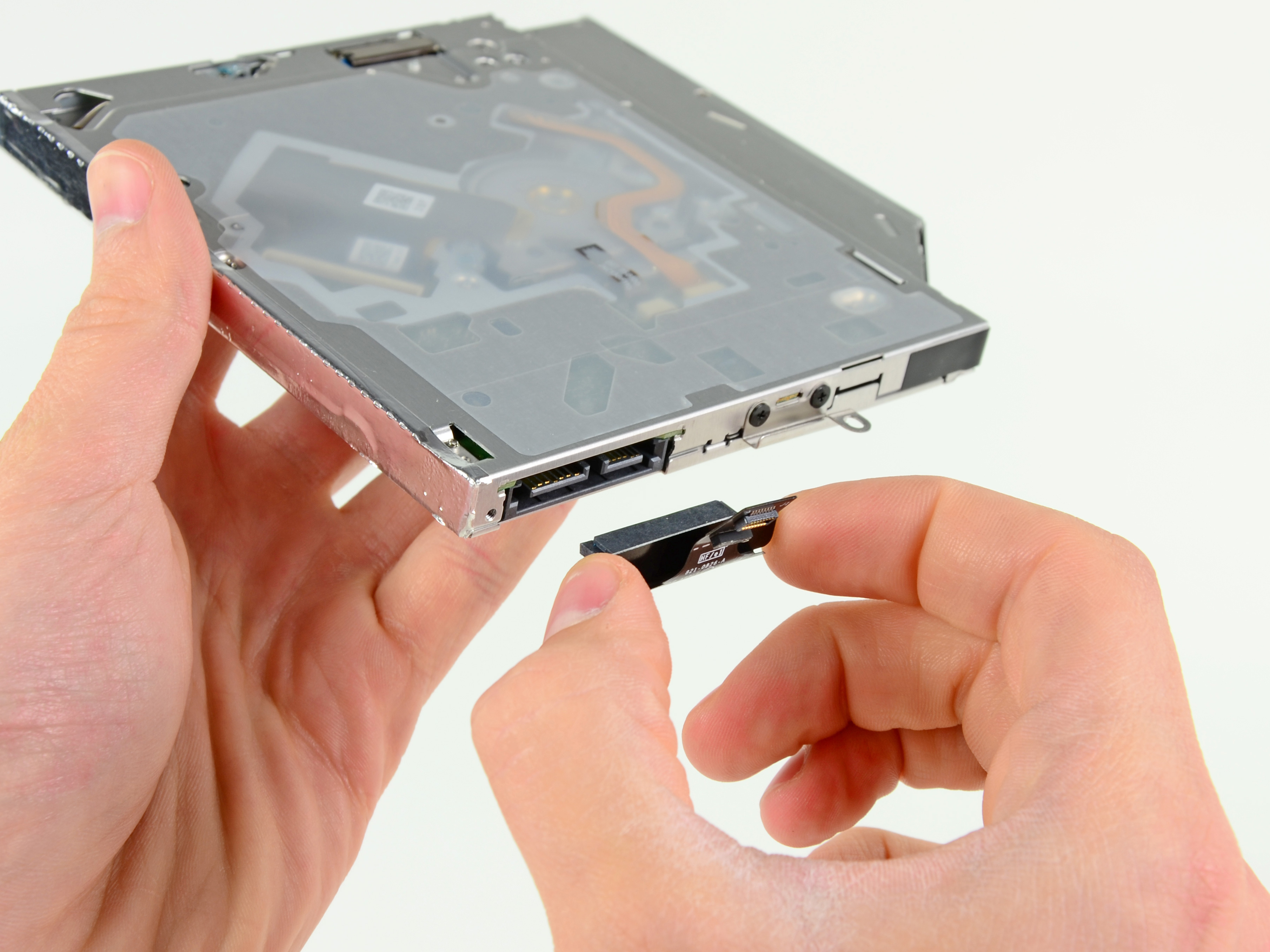

  • Use the flat end of a spudger to pry the optical drive connector up from its socket on the logic board.
Image #1 Image #2
Add Note Edit Step 8  ¶
  • Remove following two screws:
    • One 8.6 mm Phillips screw
    • One 3.9 mm Phillips screw
  • Carefully rotate the AirPort/Bluetooth board housing (with AirPort/Antenna cables still attached) out of the lower case.
