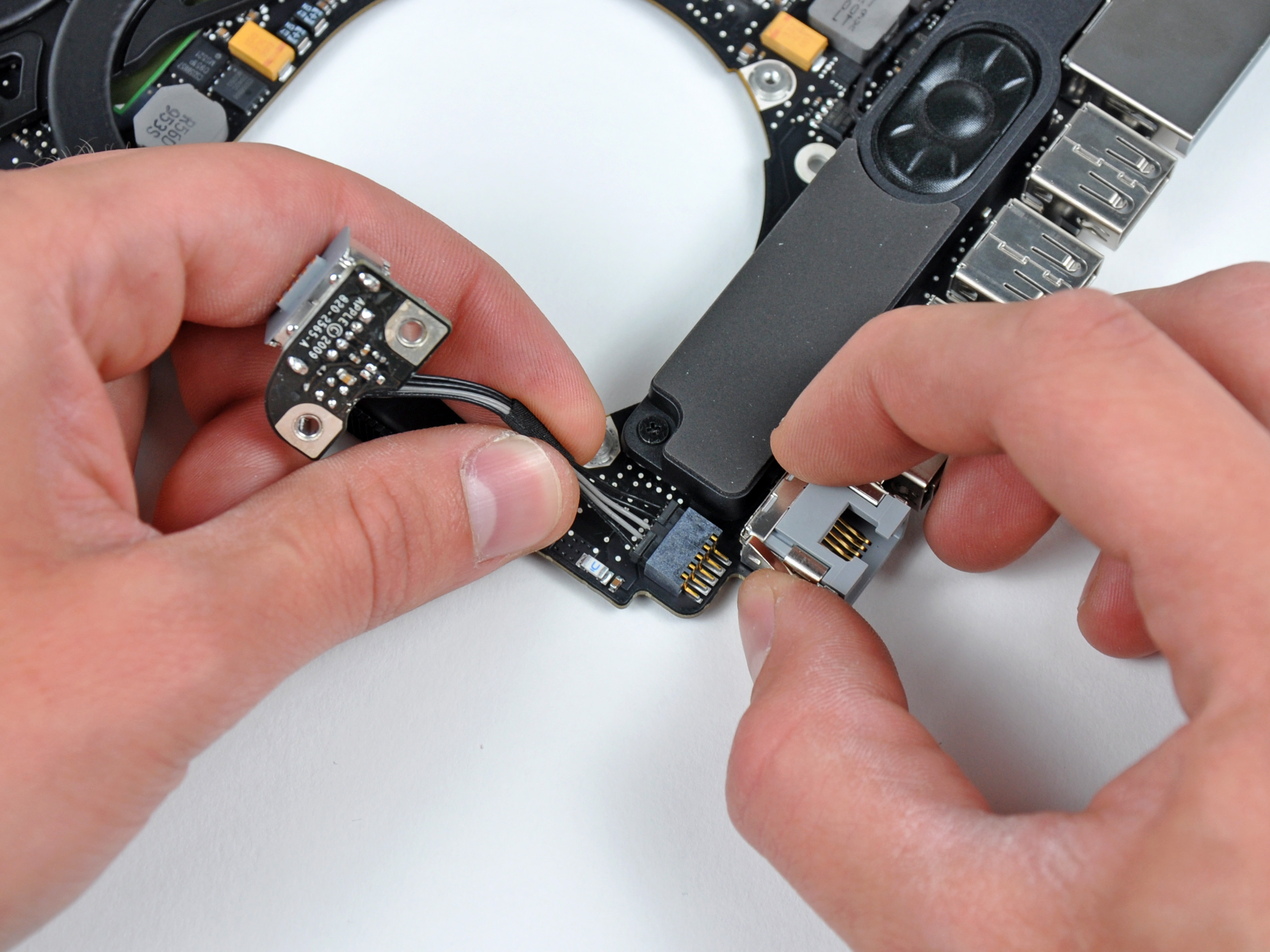

Installing MacBook Pro 15" Unibody Late 2011 MagSafe DC-In Board
Replace the MagSafe DC-In board on your Late 2011 MacBook Pro 15" Unibody.
- Author: Matt Wiens
- Difficulty: Difficult
Replacing the MagSafe DC-In board requires removal of the logic board.

Step 6
Use the flat end of a spudger to disconnect the left fan connector from the logic board.
It is useful to twist the spudger axially from beneath the fan cable wires to release the connector.
The fan socket and the fan connector can be seen in the second and third pictures. Be careful not to break the plastic fan socket off the logic board as you use your spudger to lift the fan connector straight up and out of its socket. The layout of the logic board shown in the second picture may look slightly different than your machine but the fan socket is the same.
