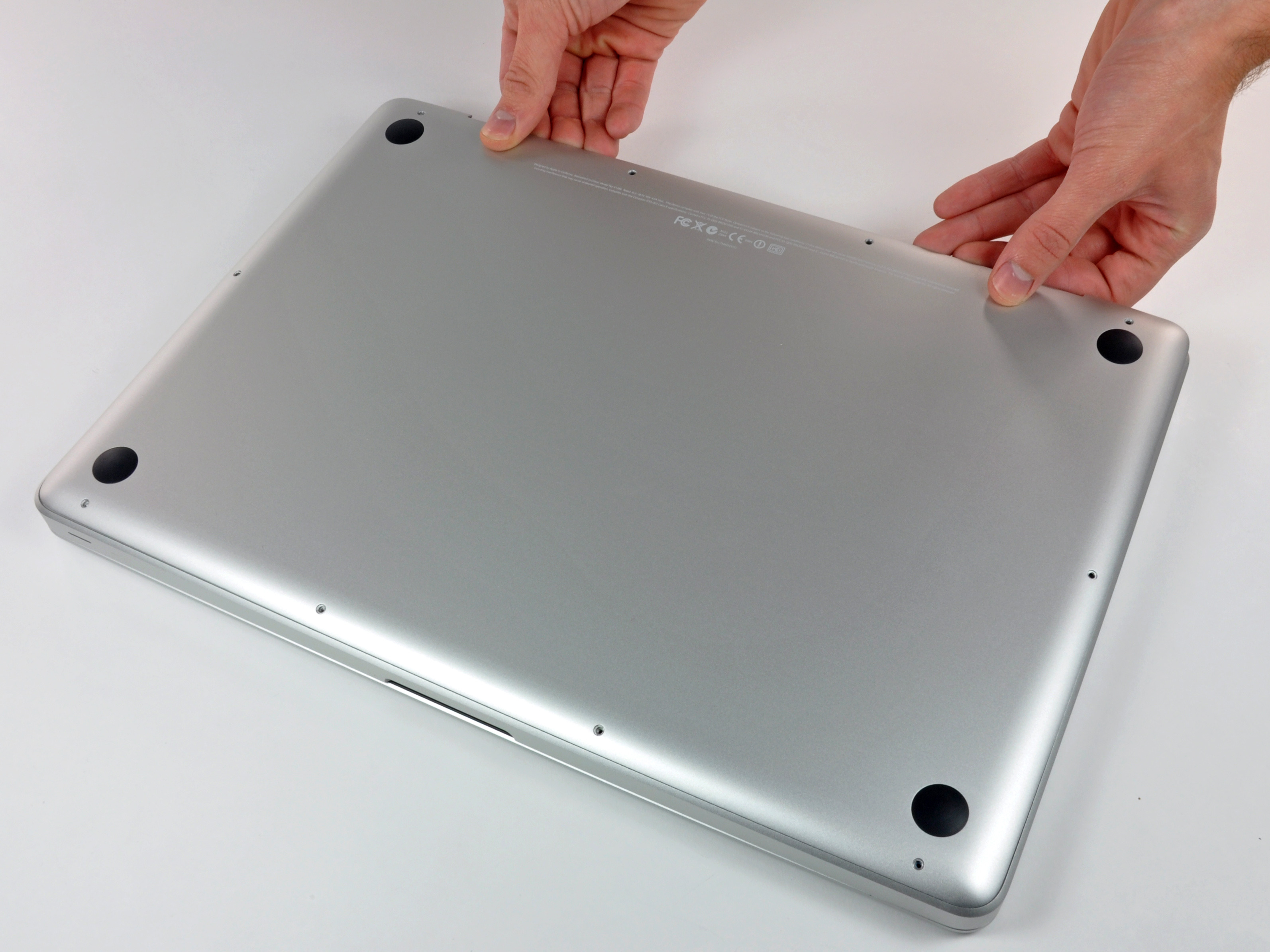

Installing MacBook Pro 15" Unibody Late 2011 Lower Case
Replace the lower case on your MacBook Pro 15" Unibody Late 2011.
  • Add Note x
Remove the lower case to access most of your MacBook Pro's internals.
first image
    • Three 13.5 mm (14.1 mm) Phillips screws.
    • Seven 3 mm Phillips screws.
first image
Add Note Edit Step 2  ¶
  • Using both hands, lift the lower case near the vent to pop it off two clips securing it to the upper case.
For more information, check out the MacBook Pro 15" Unibody Late 2011 device page.
